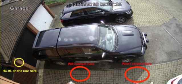

same here. I have an HC-06 on my garage controller, granted, it is behind a brick pillar but you have to walk up to the door and be no more that 6 or 7 feet to guarantee connection from a phone (where the app is). Once established, the link seems a bit more forgiving and so long as you don't go indoors or round the corner it seems to stay established to about 30 feet or so. Coverage inside the garage and to the rear is better even though there is a lot of metalwork inside.
