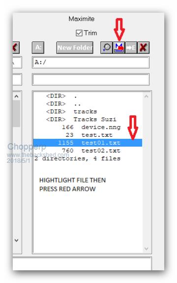

Posted: 07:22am 01 May 2018
Ah, that's what that button is for. That's not working for me either for transfer.
Don't select the Quickview button.

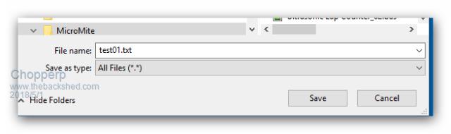

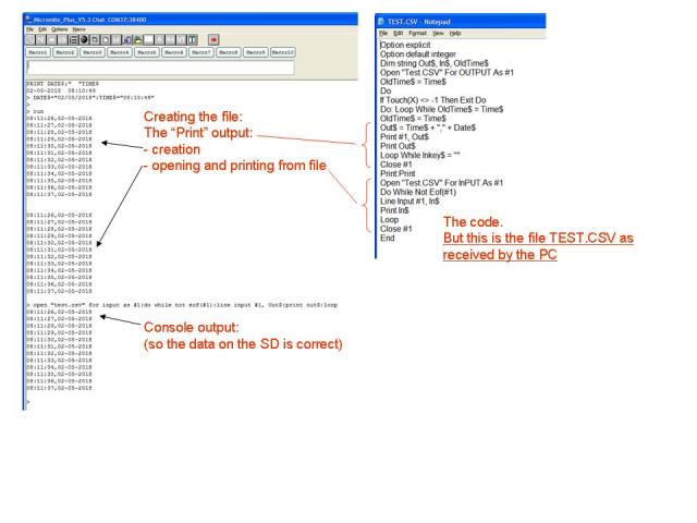

Just select the file & click the red arrow icon. (Image 1)
This will transfer the file to the directory you select. (Image 2)
You will need to open the PC directory to get the file. (Image 3)
BTW, thanks for the the other things you mentioned

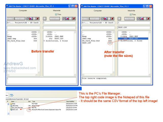

Posted: 11:05pm 01 May 2018
Hi Chopper,
Thanks but still no joy. That is what I have been doing and my screen grabs are ~ the same as yours.
(I've tried every inconceivable combination but am of course happy to try more.)

Posted: 12:46am 02 May 2018
I have just re-tried TeraTerm and it is doing the same thing. A file on the SD card that appears to be in text/csv format when transferred (via XModem) appears on the PC as a text listing of the program in the MM+ memory.
So it is not a MMEdit thing?
Andrew
