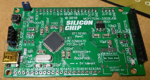

I seem to recall that Silicon Chip did a MicroMite Plus Backpack. It might have been a Geoff design, or a Peter(matherp) design, but I can't remember. That gives the MM+ feature-set, along with a graphic LCD. I think it still used an SPI LCD. I will have a hunt through my SC issues to see if I can find where it was published.

  Quote  I seem to recall that Silicon Chip did a MicroMite Plus Backpack
'The Micromite Plus LCD BackPack' - November 2016 page 64 - 73
I've built two of them, they work well. The only small difficulty is soldering the smd PIC and USB socket.
The LCD/touchscreen plugs into the raised headers on the left and right. Any additional electronics you need can be mounted underneath, the processor pins are brought out to the top and bottom rows of pins.
Note that the touchscreen has a SD card socket, so I don't use CON9 on the pcb.
Here in the UK, I think EPE also did a series of articles about it.Edited by SteveA 2018-05-01

I purchased the SC uMite Plus LCD BackPack (Nov, 2016) several months ago & have only just finished assembling it. I do not have a real purpose for it as yet. Just wanted to see what all the fuss was about with the newer 'Mites. (I do have others).
You will need good magnification & a fine tipped soldering iron (and a clean workbench) to assemble it. (Says all this in the instructions). It also needs a good clean 5V power supply. I had much fun trying to get mine to go properly, particularly the USB connection because my USB PC supplies were bit below par & couldn't handle the LCD backlight above about 10%.

  Quote  I had much fun trying to get mine to go properly, particularly the USB connection because my USB PC supplies were bit below par & couldn't handle the LCD backlight above about 10%.
I had that problem too. I found using a short USB lead with thick copper cores helped, I think it was voltage drop caused by resistance in the cable.

  SteveA said   The only small difficulty is soldering the smd PIC and USB socket.
Totally agree with that, SteveA.
Can you elaborate on how you mount extra stuff? I've got mine socketted onto a big bit of a strip board ATM (with power supply) for testing etc until I decide what to do with it. Be room underneath for some stuff as you mentioned.

Thanks chaps. Looks a big lump with capabilities I don't need. And lots of assembly to do, and comes without TFT that must be sourced separately. But might be the best option. If our rotten weather continues I might have plenty of spare time.

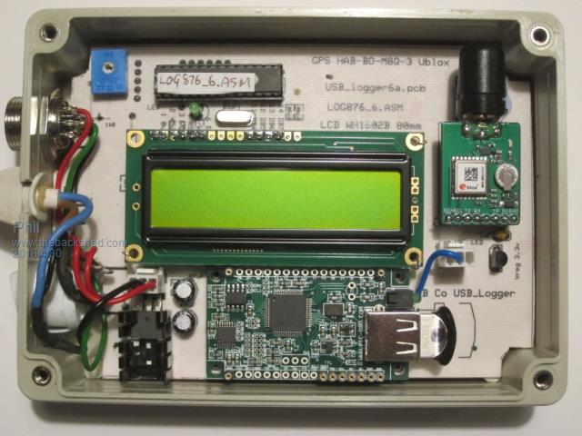

Attached might be an image of my last effort which used a PIC32 USB storage module. All the hard work done for me though the file formatting was unusual!

The MM LCD Backpack, MM V2 LCD Backpack and MM Plus LCD Backpack are great designs for Colour LCD Panels.

The MM plus LCD backpack is the same physical size (2.8" 320 x 240 screen). It does use SMD but is so capable. The SD card works well, four serial ports etc.
