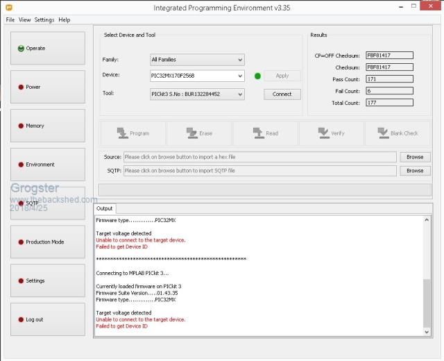

I cannot make IPE connect to one of my MM chips, no matter what. I have tried all sorts of things.
MM2 170 chip in SSOP footprint. Pins 4 and 5 are NOT connected to anything else - they are reserved for the ICSP.
MM2 powered by on-board 3v3 regulator, PK3 set to NOT power the device.
All I get is this message over and over:
EDIT: Text in image is a little fuzzy. It says:
Unable to connect to the target device.
Failed to get device ID.
If I use Rob's PIC32PROG GUI application, I can program the chip just fine, so I know the link wires etc from the chip to the ICSP are fine, or I would get an error message when PIC32PROG tries to re-flash the chip.

Can anyone suggest why stupid IPE is unable to talk to the chip?
I need to be able to READ the device into a HEX I can then use to flash other units.
This process works well, if you can get stupid IPE to co-operate.

UPDATE:
Well, after installing the latest update to 4.15, the PK3 now sees the chip and can connect and read it fine.
Crisis averted.

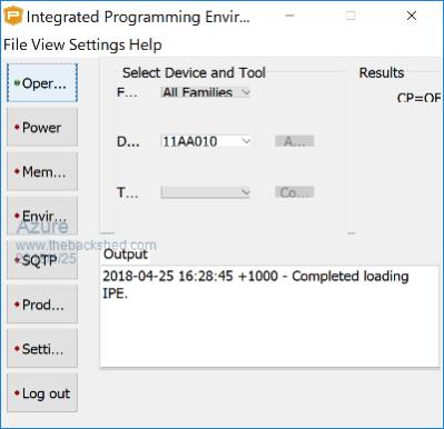

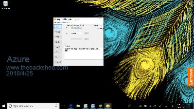

I have different problem with Microchip IPE (and IDE). I share your pain with IPE Grogster.
My notebook has a 4K resolution screen and this is one of a few apps that do not display properly. Here is what it looks like on my screen. I have tried several version up to current 4.15 optimistic that they will get it fixed.
Here is what the app screen looks like closer up. This is in advanced mode (normal mode has the same problems) most of the screen is not displayed and there is no way to access the bits that are not showing.
The problem is in their development environment which is based around netbeans. There are some supposed fixes but nothing I have tried so far fixes it. The latest netbeans is supposed to be better but the Microchip IPE and IDE are still using old verion.
My current solution is to dig out my old machine (a MAC) and move everything I need to that. So I avoid using either app even though I sometimes want to.

Can you change your screen resolution to something less then 4k for the purposes of testing? That would probably make it display OK. You would have to put the resolution back to 4K later, but that might be a work-around.

  Quote  My notebook has a 4K resolution screen and this is one of a few apps that do not display properly.
Works fine for me on 4K. What is your display scaling - normally defaults to 150% for 4K and that is what I'm using

Posted: 11:37am 25 Apr 2018
Wonders never cease.
I just tried resetting everything again and it now works. With my normal settings (resolution 4K and scaling 300%).
@Grogster
I have previously tried changing the scaling many times on several different IPE/IDE versions, including reboots in between changes and every other tip I could find, none of them had worked before.
@Matherp
I usually run my screen scaling at 300%, it is the recommended setting and I find it makes emails and forum text readable. It is only a 13" screen so even 150% is still small (to me anyway).
I won't try to figure out why it didn't work before, I'll take it as working as is and leave it at one of the wonders of Win10 (maybe its a post for that long win10 thread).

Tried to read an updated MM firmware today with the latest version 4.15, and got exactly the same freakin' errors - again. So Microchip have not fixed this issue as I thought they had when I was able to read the chip the other day after the update. Mother-
EDIT: Tried another USB port from the one I normally use for the PK3, and this time it did work. Still seems a little flaky to me though. Edited by Grogster 2018-04-28
