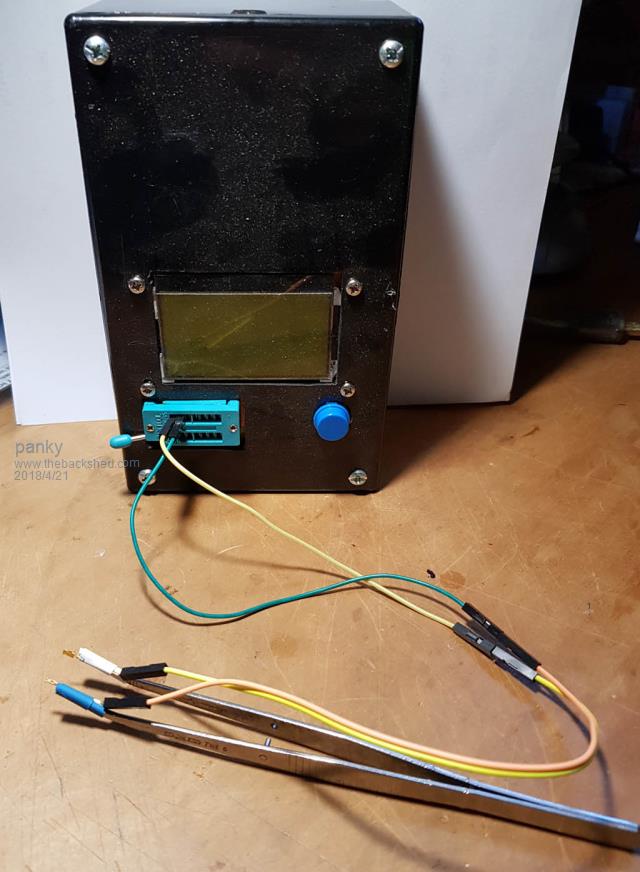

Several months ago I decided I needed to start using SMD so embarked on a couple of projects that used a number of SMD resistors and capacitors (1206).
While the resistors have the value marked, capacitors don't which is frustrating.
I ordered one on these and had it delivered for pick-up at the local BigW store - took about a week.

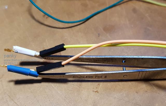

In order to simplify the measuring of SMDs, I put it in a case and built a custom pair of leads like below
The tweezers were a spare pair I had and the two insulated "fingers" were 2 legs from an IC socket.
As well as measuring resistance, capacitance (also displays ESR), it can measure inductance (again unmarked in SMD) as well as transistor, diode, FET etc.
I find it invaluable as it is now a very simple matter to do a quick check of each SMD cap before I solder them on board.

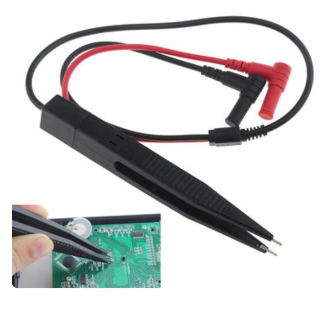

I also bought one of these for £3.99 very easy to use and very handy.

Of course there are tools already for that purpose and cheap as Chips... Less than $5AU inc postage.
Aneng Tweezer Probe
