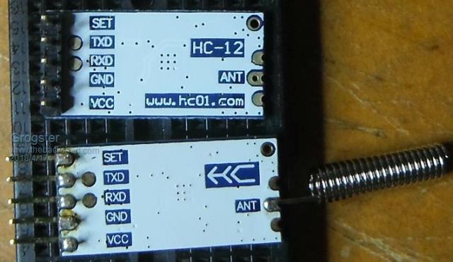

I spent most of today, tearing my hair out trying to work out why the hell HC-12's that I have used so many of in the past, would not talk to each other.
If you have two of the older model, they talk fine.
If you have two of the newer model, they talk fine.
If you have one old one and one new one, they DON'T. You will get some messages, but more then 50% of transmissions are ignored by the receiving end. I have no idea why that should be. Triple checked all connections, configuration etc, but if you have one old and one new, they are f-ing hopeless together.
I can configure both with Rob's HC-12 tool, and they both read and write the config just fine, but when you put them online to actually talk to each other, the performance is appalling.
As soon as I put an identical one from my new batch with the thing I was trying to get going(which used the exact same module), it sprung to life with 100% message reliabilty as I have come to expect from the HC-12 modules.

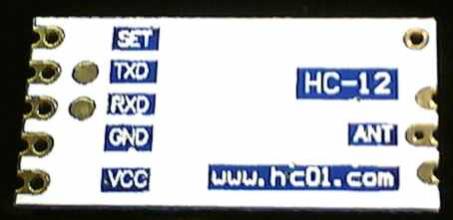

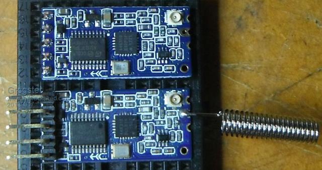

Looking at the modules up close, they appear to be identical electronically, but there is a silkscreen difference with the newer ones over the older ones:
The module with the helical fitted is the OLD one. Note that the newer one has the website on the bottom silkscreen.
The only thing I can think of is that in the newer ones, they have changed something in the code for the on-board MCU, with respect to the way that it talks to the RF chip or something - it makes no sense to me. Has anyone else seen this with their HC-12's?
As I say, not a problem if BOTH(or more) are all the same one, but if you mix them, the results are terrible - even though all the settings are identical.

No, both have helicals. I just left the helical on the old one, so you can easily see the difference between the two in the photos.

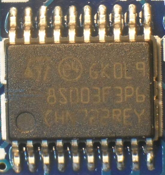

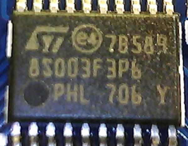

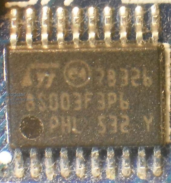

Here are close-up shots of the MCU's, which do appear to be a different part number:
OLD HC-12 MCU:
NEW HC-12 MCU:
It is possible I am on the wrong track here - I don't really know my ST part numbers, so it might just be an equivalent part.
EDIT: I take that back - they both seem the same. The ST part number would appear to be the 2nd line, not the first one. Both 2nd lines match, so I expect that is the actual MCU part number, meaning both modules are EXACTLY the same.

This is the chip the bottom right is the date and revision code (page 93 in the manual).
So they are both rev Y of the same chip AFAICT (as far as I can tell).Edited by Azure 2018-04-18

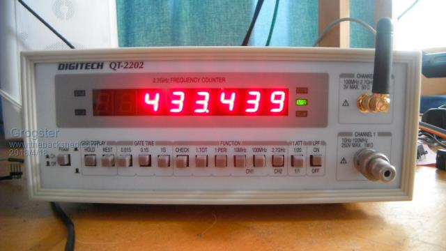

Posted: 01:33am 18 Apr 2018
Yes, that was my thoughts anyway.

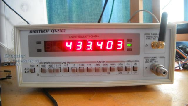

Here is a little evidence of what I am saying:
NEW module on Channel 1(433.400MHz):
OLD module on Channel 1(433.400MHz):
Definitely a 30kHz or so frequency problem.

  Grogster said   Yup, the new ones are 37kHz out on the 433MHz band too.
I reset the new module to Channel 1(433.4MHz), and they are NOT there on 433.400MHz on the scanner, but they ARE there on 433.437MHz....
Hmmm... I am wondering if there is something "hooky" about the new modules you have.
The ones I have in stock (with the URL on the silk) match precisely what you show and according to my scanner, 433.4MHz - not as precise as your measurement though.
pix...
Only difference I see is mine have a Philippines version Y of the chip whereas yours are China (?)
I think from what you are showing, they are out of spec with the datasheet - that's enough to go back to the supplier I reckon.
