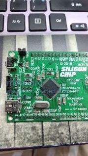

Hi peeps.
I had a Micromite Plus LCD Backpack running perfectly without any bugs or errors. Initially I powered up the board using USB console at CON8, so I fit the jumper JP1.
Then I changed the power connection from CON8 to CON1 (without removing the CON8 connection). But I forgot to remove the JP1! After some times running the MM+, the board cannot be connected to the PC anymore. It keep connect and disconnect itself from the PC. Same thing happen for any connection I made.
Is it because of the JP1? How should I address this problem?

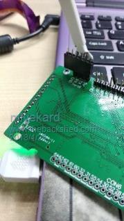

  Quote  When you say "I changed the CON8 power connection to CON1", are you connecting ONLY 5V and GND to CON1?
Tx and Rx also connected. Refer image below.
  Quote  how are you connecting the Micromite to the PC in this configuration?
Initially, I use CON8 as power and I fit JP1. Then, I changed to CON1 as power and CON8 for transferring data. The problem is I forgot to remove JP1 for my second connection!
