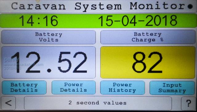

PS. Quick peek at one of the user displays.

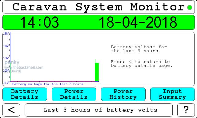

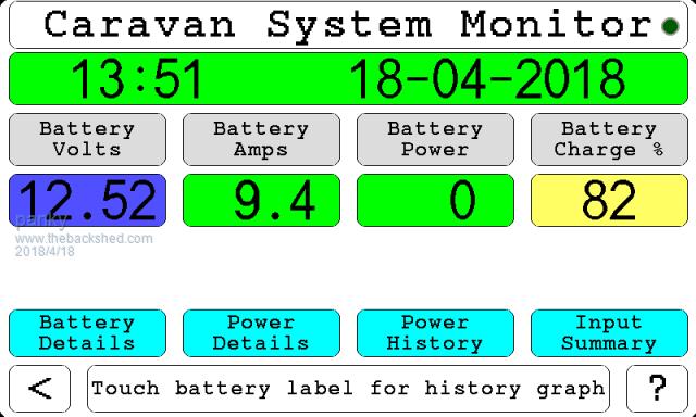

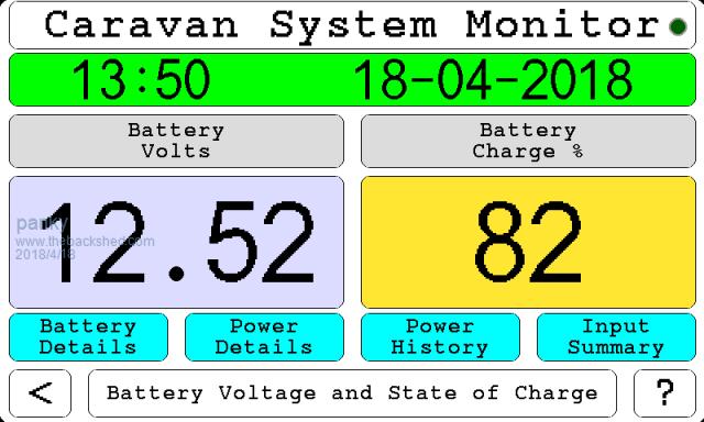

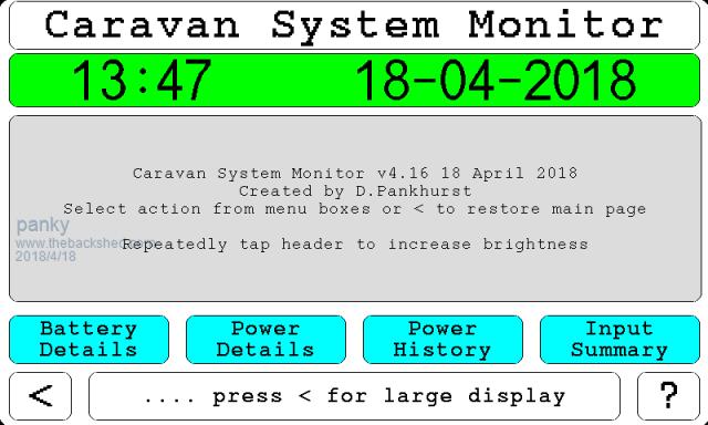

Update:
Fixed a few bugs and got the history graphs working.
The software below will work in simulate mode if COM1 Rx and Tx are looped back.
Had a struggle with integrating GUI displays, touch and plain graphics - I hope the comments are enough to explain the operation. A detailed explanation can be found on Fruit of the Shed here however the software below is the latest and most stable version.
Some screen shots:

elseif ActivePage = 2 then ' battery details
gui fColour rgb(black),DB_Val_5
gui BColour rgb(80,80,255),DB_Val_5
CtrlVal(DB_Val_5) = str$(BVolts,2,2)
if BAmps < 0 then
gui fColour rgb(black),DB_Val_6
gui BColour rgb(red),DB_Val_6
CtrlVal(DB_Val_6) = str$(BAmps,2,1)
else
gui BColour rgb(GREEN),DB_Val_6
endif

elseif ActivePage = 6 then ' help box
ctrlval (Hint_1) = ".... press < for large display"
ctrlval(Help_Box) = Help$
elseif ActivePage = 7 then ' large character Battery Volts
ctrlval (Hint_1) = "Battery Voltage and State of Charge"
CtrlVal(LDB_Val_1) = str$(BVolts,2,2)
ctrlval(LDB_Val_2) = str$(BatCharge)

' graphs that overlay GUI areas
sub BVGraph ' graph of battery voltage over last 3 hrs
' draw out running graph frame, ticks etc.
local volts,yrg,xrg,rg_abv,BV3HrPtr
Colour RGB(black),RGB(white)
volts=15
For yrg =130 To 330 Step 50
Text 12,yrg,Str$(volts,2,0)+"V",LT,1,1,RGB(blue)
volts=volts-1
Next yrg
Line 40,130,40,330,2,RGB(blue)
For yrg = 130 To 330 Step 5 'minor ticks
Pixel 38,yrg,RGB(black)
Pixel 39,yrg,RGB(black)
Next yrg
For yrg = 130 To 330 Step 50 'major ticks
Pixel 37,yrg,RGB(black)
Next yrg
Line 40,330,400,330,2,RGB(blue) 'now for the bottom
For xrg = 40 To 400 Step 30 ' 15 min ticks
pixel xrg,331,RGB(black)
pixel xrg,332,RGB(black)
Next xrg
For xrg = 40 To 400 Step 60 ' half hour ticks
pixel xrg,333,RGB(black)
Next xrg
For xrg = 40 To 400 Step 120 ' hour ticks
pixel xrg,334,RGB(black)
Next xrg
Text 50,335,"Battery voltage for the last 3 hours",LT,1,1,RGB(blue)
' now fill graph
BV3HrPtr = BV3HrPointer - 1
if BV3HrPtr < 0 then
BV3HrPtr = 179
endif
' paint out pixels into graph for running values
if BV3HrArray(BV3HrPtr) = 0 then
BV3HrArray(BV3HrPtr) = 12.0
endif
For xrg = 41 To 399 Step 2
rg_abv = 330 - Int((BV3HrArray(BV3HrPtr)-11) * 50)
If rg_abv > 330 Then
rg_abv = 330
EndIf
if rg_abv < 260 then
line xrg,rg_abv,xrg,329,2,RGB(green)
elseif rg_abv > 260 and rg_abv < 270 then
line xrg,rg_abv,xrg,329,2,RGB(yellow)
elseif rg_abv > 270 then
line xrg,rg_abv,xrg,329,2,RGB(red)
endif
BV3HrPtr = BV3HrPtr + 1
if BV3HrPtr =180 then
BV3HrPtr = 0
endif
Next xrg
End Sub
