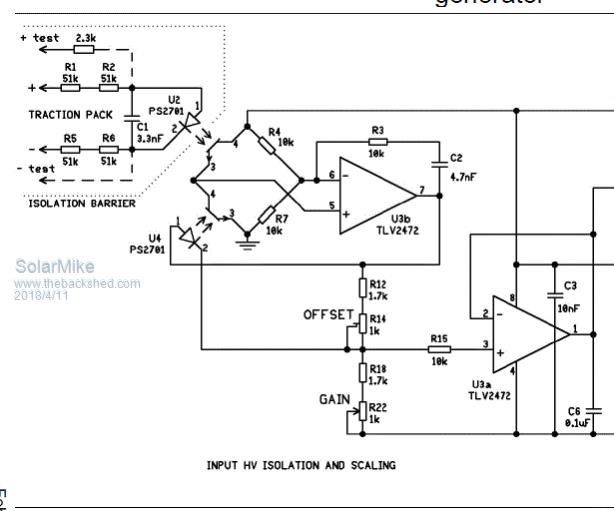

Have a look at this article, it describes a circuit that uses two opto-couplers in a bridge arrangement, one is driven by the high voltage you want to measure, the other is part of an op-amp feedback circuit that maintains a balance in the currents flowing and thus the ratio of voltages. Thus no transformer required.
I was going to use something like this to measure 300V DC battery sets powering high voltage inverters. For AC just rectify the supply.
Article Here Page 6
