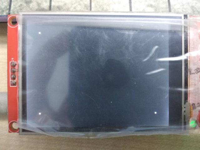

Then I write 'GUI TEST TOUCH'. When I randomly touch the screen, somehow there are 3 dots appeared.

Rather weird, It has definitely calibrated OK, I usually just drag my finger nail across the screen and it draws a trace. I take it the plastic is to stop the camera flash reflecting. Other than that maybe Matherp can help, or send a PM to WhiteWizzard.

I drag my finger nail across the screen but no trace drawn on the screen. Is there any other solution?

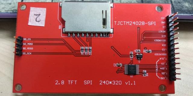

Are you sure your display has the TOUCH function. It is possible to buy displays without this function. They still have the touch pins on the back but U1 is missing from the board.
Paul.

I have U1 on my TFT board.
I did continuity test using multimeter and all connection are just fine. So I guess there is no soldering issues?
Eventho I remove the plastic film from the screen, the touch still cannot be traced.
