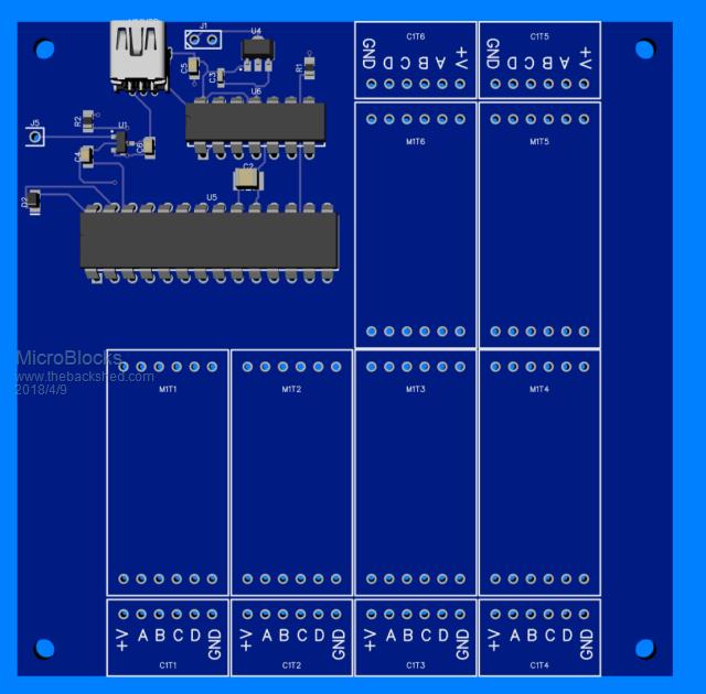

Posted: 01:27pm 08 Apr 2018
They are fast. Just got confirmation that it is packed and ready to ship first thing tomorrow. Good start.
I made a quick pcb layout which matches the size 2 enclosure. Just thrown in the components to see if there is enough room. :)
It has a USB connector, the 1455 and the MX170. All through hole! And it still fits. Also (still smd) part for supervisory and 3.3v regulator, together with the neede3d caps and resistors. They can easily be replaced with through hole parts also.
The 64 or 100 pin chips in TQFP packaghes would fit also when all the other parts are also SMD, but that is for later.
This size 2 enclosure would also be a perfect fit for a Color Maximite. Together with some joystick (D9) connectors, Keyboard (PS/2) and a VGA (D15) it would probably fit comfortably.
Edited by MicroBlocks 2018-04-10
Posts: 10044
Posted: 11:40am 09 Apr 2018
I see that those cases also come with LED light-guides, so you can have SMD LED's for indicating thing, and that is accommodated. The size 2 case allows for up to eight LED's - not bad!
