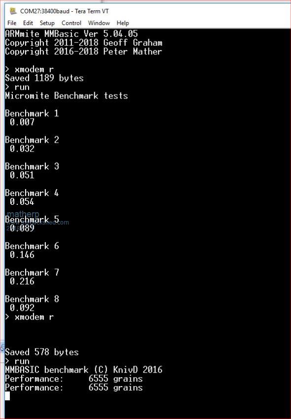

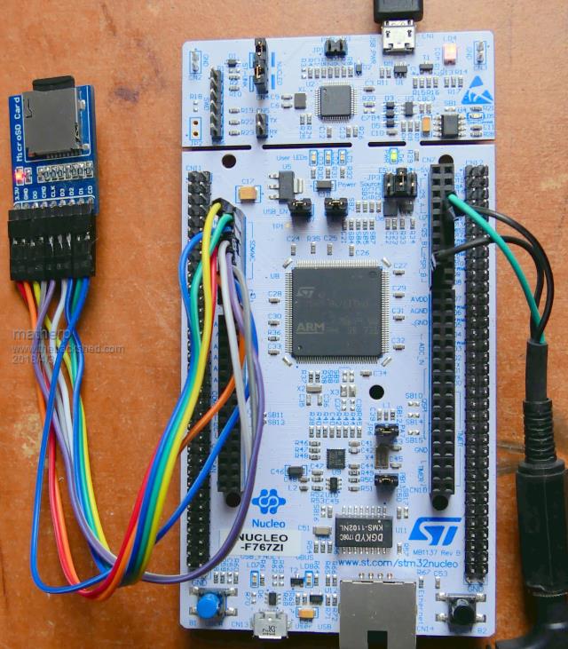

In preparation for the availability of the STM32H7 (400MHz). I've been working to get MMBasic running on the STM32F7. My development board is a Nucleo-F767ZI which other than the H7 is top of the STM line-up:
216MHz
2MB flash
512Mb RAM
Double precision FPU
In essence then it is very equivalent to the PIC32MZ.
In practice at 216MHz it is just marginally slower than the PIC at 252MHz, but considerably faster than the PIC at 200MHz.
What then are the advantages of the STM?
ARM core - so much more mainstream
Much better software infrastructure - free high quality IDEs and compilers
2 * 12-bit DACs so enhanced audio capability
Cheap development boards ideal for building into projects
The current status is that MMBasic is up and running with the latest Micromite version. SDcard support is fully implemented and uses the fast SDIO 4-bit parallel interface (this should also be possible on the PIC but the documentation and support for this is so poor that there is no evidence anyone has got it working).
Audio is fully implemented with support for WAV and FLAC file payback through the DACs, Tone generation and SAM test-to-speech (like the MMX). Programs can be downloaded through MMEdit or XModem and the editor is fully functional.
This cracks the hardest bits of the port but left to do are the wide range of other IO and TFT capabilities of the Micromite.
I'm changing the philosophy of the port slightly from the Micromite. As it will only run on 144-pin chips, it is sensible to allocate pins to dedicated functions - something I know Geoff has also considered for these larger chips. So the SDcard pins will be fixed and not available for other uses. Likewise the audio pins, I2C pins, SPI pins and probably PWM and interrupt pins. This will still leave 50+ pins for general I/O with around a dozen of them 12-bit analogue capable.
As always comments and ideas appreciated but not always actioned

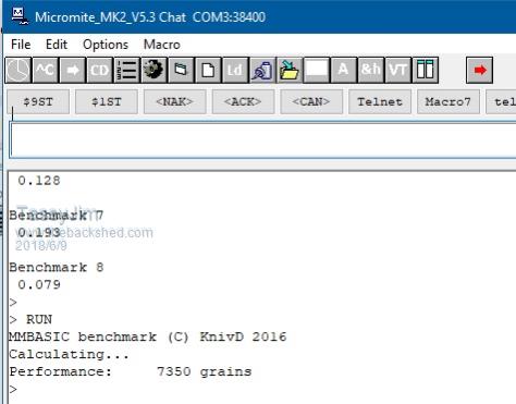

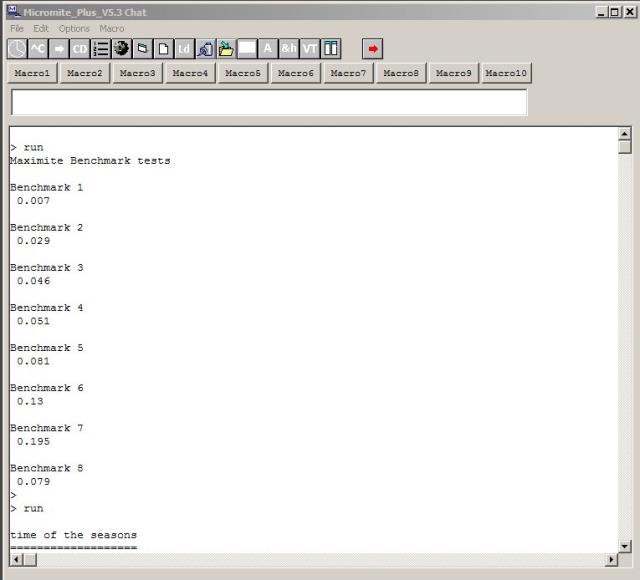

First runs on STM32H743
darthmite
Joined: 20/11/2011
Posts: 240
Posted: 08:56pm 10 Apr 2018
Hi Math , do you use the NUCLEO-H743ZI ?
I have ordered one last day , don't know when it come to home
Can you compare this bench with the PIC MX/MZ for see the diffs ?
Cheers.
Posted: 09:42pm 10 Apr 2018
  Quote  do you use the NUCLEO-H743ZI ?
Yes, now in-stock at RS
  Quote  Can you compare this bench with the PIC MX/MZ for see the diffs ?
See this and this
