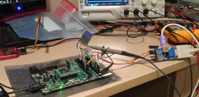

Here is the debug setup with ps2/vga breakout board and sd card socket. Upper left is bottom of the mmbasic editor in the monitor. Yes, had to enable vga in basic since the pins are conserved on initial startup.
