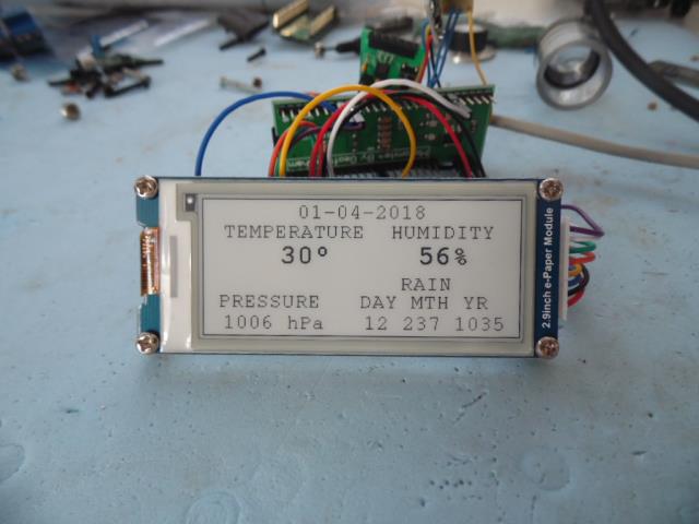

Got it working. I am using an old HH10D humidity sensor all my DHT22 sensors don't work. I have had about 6 of them and they all fail. I guess I should buy genuine but how do you know. The rain figures are fake, I have a problem with the reed switch in the sender not switching properly so have to wait for a new one.
Paul.

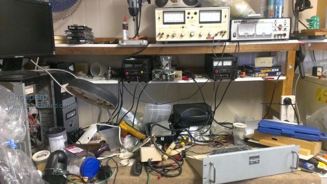

Posted: 10:18pm 31 Mar 2018
Looks good Paul.
Nice to see some clear space on a work bench as well :-). I have a hard time keeping free space for doing stuff on any of mine.
ChopperP
ChopperP

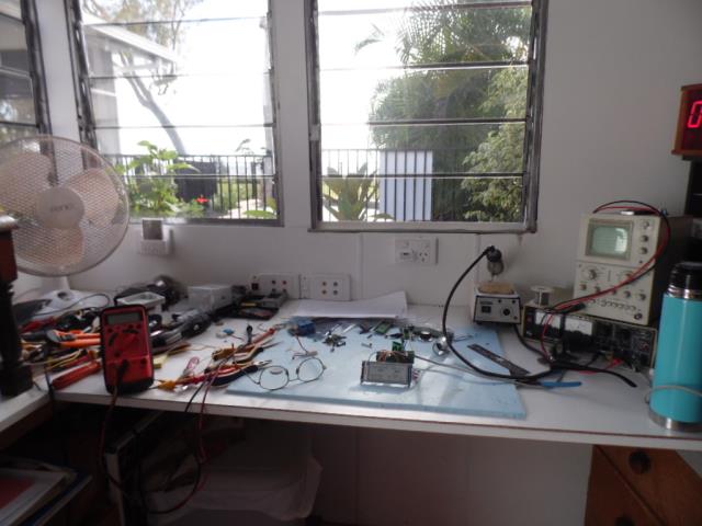

palcal
Joined: 12/10/2011
Posts: 2052
Posted: 10:34pm 31 Mar 2018
Like this.
Paul.

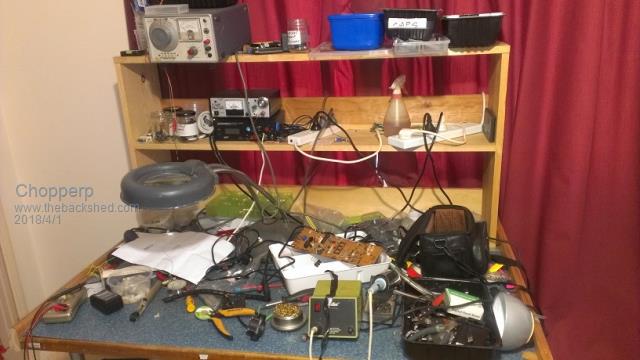

Posted: 06:32am 01 Apr 2018
Paul
2 of my benches at the present time. Do a lot of dumping on them. Yours is good.
ChopperP

Posted: 09:18am 01 Apr 2018
Yes, I am happy with the display and it can be seen in sunlight but really only good for something that only needs updating occasionally.
Thanks for that re DHT22 I had not done that.
Paul.
