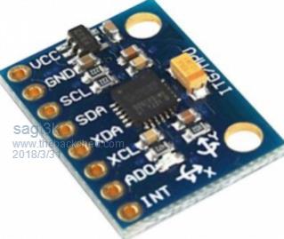

This is the module (that has its resistances in pullup):

I changed it to close the I2C after each read and stop when the timeout occurs.
It also confirms that the error occurs with the READ, not the WRITE.
The reading before the failed one takes the usual time. ie it is not failing gradually.
Changing the delay between reads from 25 to 250mS made no difference.
Adding a few extra delays between various operations made no difference.
I don't have any devices connected to the Explore64 other than the MPU6050.
It is powered from a separate 5V supply and the same supply for USB and Serial tests.
Using TeraTerm on Windows for all tests.
Using the USB connection, the timeout error can occur anytime, up to 250 seconds in some cases.
Sometimes (but not always), if I try to restart the program immediately, the timeout error occurs immediately. Removing power to the MPU6050 clears the error. So (I think)does waiting for a while.
No failures (yet) when using the serial converter for the console.
I haven't tried any other I2C devices to see if it's just the MPU6050 that has issues.
