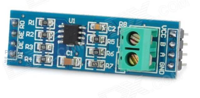

Hi All,
Have a few of these modules.
Presume I can't directly connect them straight to a 28 pin chip.

No, unfortunately you are stuck. The inverted polarity of the DE pin is a 'feature' of the PIC32 hardware that MMBasic uses and annoyingly cannot be changed.
Using the ChangePin CFunction also will not help. The LATINV parameter will flip a pin into its opposite state (ie, a hi to a lo). It does not invert the data.

These are easy to use and require not much space:
http://www.onsemi.com/PowerSolutions/product.do?id=MC74VHC1GT04

What about using an alternate pin to "fake" DE?
Would something like this work, if Pin 6 was connected to the DE of the MAX485.

The general idea may work (I don't know) but I think that example will not - because the Print #1, ReqFrame will still be sending chars from the internal buffer when the pin is set low.
If it is to work I think you'd have to wait for the buffer to be empty before dropping the pin.
I think MMBasic does let you test for the buffer being empty. I'm not sure if you'd also need to add a small delay? (To make sure the char transmission has finished.)

  Phil23 said  would it be possible to do something like this with an embedded C-function that allows another pin to follow Pin 7, but in an inverted state?
Phil.
Phil,
If you have 2 pins spare you could handle this in your code without the need for a C-Function. Assign one pin as a Digital Input and connect it to the DE pin (7). Assign the second pin as a Digital Output. In your code add an Interrupt on the Input pin activated on both Hi and Lo transitions, and in the interrupt handler just set the output pin to the opposite polarity of the input one - so it becomes the DE inverted pin to connect to your RS-485 module.
It would add a very small delay to the DE signal transitions, not sure it this might cause any problems at the start of transmission. Maybe you would need to transmit a dummy character at the start of the real data just in case the first character gets missed due to any DE latency.

Also some alternate Modules arrived yesterday.
These,
https://www.aliexpress.com/item/TTL-turn-RS485-module-485-to-serial-UART-level-mutual-conversion-hardware-automatic-flow -control/32709226383.html?spm=a2g0s.9042311.0.0.0pGBWV
They might be easier to live with as they handle the flow control themselves.
