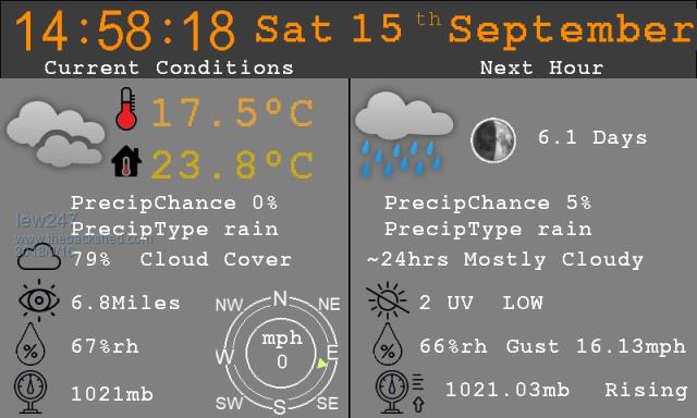

Just thought I'd show you my latest version of the weather station
This one works using only an ESP8266 to get the weather from any weather server - I use openweathermap
and a temp sensor for indoors

Thanks Peter, I couldn't have done it without your massive help and all the help from others on the forum here, I'll name them all later once I've finalised how it's going to be.
I'm considering making a board that an Explore 64 will plug onto the back of the display rather than using an Explore 100
And I'll post the code later if anyone is interested

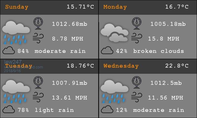

New version, slightly updated, I added leading or trailing 0's where needed
and I centered up some of the icons
The reason the "Snow" isn't centered is because there are longer words for other descriptions, and I didn't want them crossing into the box on the right
Oh I forgot to add in the previous post, that I'm using ESP Basic to get the weather code from Openweathermap and parse it, so the only thing the Micromite is really doing is displaying what's being received
I'm actually quite pleased with it.
I'm going to make a circuit board either with a 64pin MM that fits on the back of the 7" display, or one that the Explore64 plugs into then fits direcely on the back of the display
It's a waste using an Explore100 for such a simple task.
Unless someone else want's to make a board with an PIC32MX470F512H-I/PT or similar that MM Plus runs on and plugs directly onto the back of the SSD1963
The only external components it needs other than the bits to make the MM work a Mini SD Card socket and either a DHT22 or DS18B20 and an ESP8266 ?
it would need the following I believe
1455 USB Serial Interface
5V 1A regulator
3.3V 500mA regulator
Micro SD card connector
Micro USB connector
and the various caps and crystal to connect to the PIC32MX470F512H-I/PT
and a 40 pin header to fit onto the back of the display panelEdited by lew247 2018-03-18

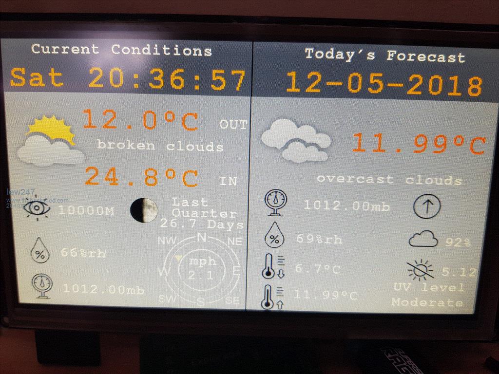

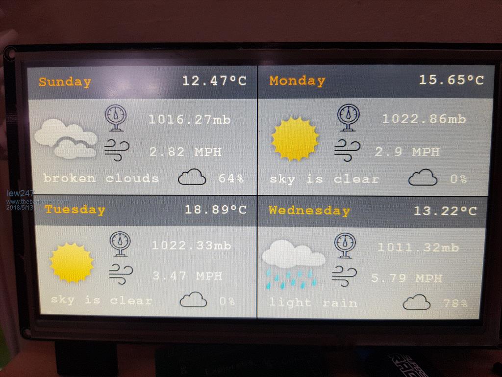

I completely redesigned the display
I think it looks a lot better than the 1st one with "Big Ben"
Many thanks to Jman and Disco4now for helping me to get the touch working properly and the parsing of the data correct for both screens
Next step is to figure out how to make a graph so there will be a 3rd screen showing data over a period or periods of time.
