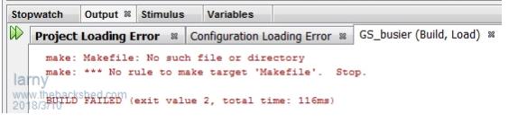

I recently installed MPLABX & have used it to write a programme.
But when I tried to Build it, I received an error message as in the attachment

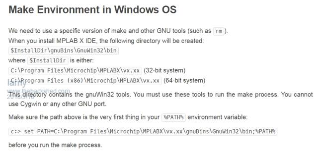

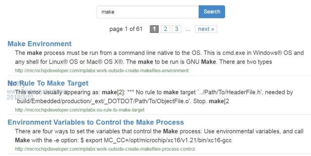

Output.jpg. I have searched for info on how to set up a Make file to no avail. The Help did not help. See the attachments Make help & Make environment.
I don't understand the Make environment attachment.
Any assistance will be appreciated.

MPLAB X uses make to 'orchestrate' the building of the program. make is installed as part of the install of MPLAB X.
I don't know what is wrong in your setup but make is trying to build a file/project called Makefile and it does not have the instructions to do this. Normally make and its scripts are hidden from the user of MPLAB X so this indicates something is seriously wrong in the project configuration.
My solution would be to start a with completely new MPLAB X project and not fiddle with any of its settings. There is are a lot of things that can go wrong here - it is not an easy process.
