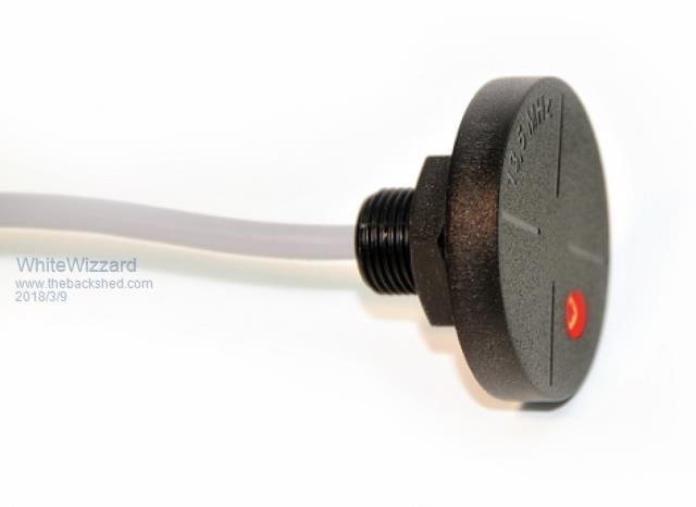

I have a one-wire RFID reader here on my desk connected to a 28pin BackPackv2. This reader can work easily with the MM by using the one-wire protocol built into MMBASIC.
The detection of lack of presence is very easy to accomplish - however, note that the circuit will pull slightly more current when a tag is within range - not a problem though for you by the sound of it.
If you use a 13.56MHz version of the reader then it has an added bonus. IF you place an RF bank-card (in the 'target' wallet) then this behaves as the NFC tag!
I will post a picture of the reader in a little while!
Posts: 2998
Posted: 10:40am 09 Mar 2018
The One-Wire RFID reader as mentioned in my previous post. I have not added these to the website ye; however, I do have both 125KHz and 13.56MHz versions immediately available.
Will post a code snippet next to show ease of use

NFC is typically just a few centimetres. This reader will read a bank-card's NFC chip at approx 2cm. So the 'bait wallet' needs to pretty much be sitting on the reader. This is just fine as the wallet won't be moving by itself so 2ft just not needed (to avoid false alarms).
Active RFID tags are needed for a 2ft range - or alternatively expensive passive technology. Is there any reason (other than false alarms) that you require a read range of 2ft?

Forgot to mention that the reader pictured above has a diameter of approx 35mm; and a max read range of 4cm
And low cost 13.56MHz NFC 'stickers' can be used on other 'bait' items - however, only one tag can be read at a time.
