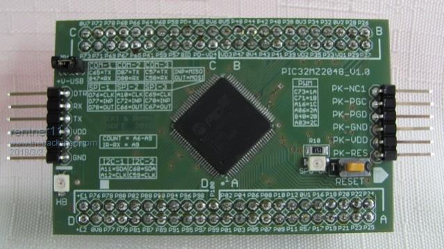

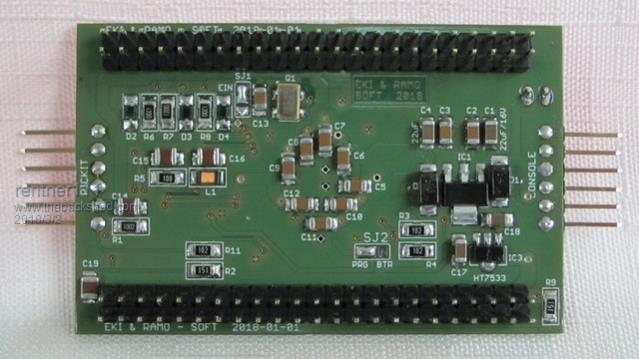

Our new board from the PIC32MZ2048EFH100I/PF.
Operating voltage is from 6V to 12V.
There is a voltage regulator for the 3V3 supply of the processor installed.
Another 3V3 voltage regulator is available for the analog voltage.
All port lines are routed to the pin header.
For VGA applications, the 3 resistors and the 3 diodes are on board.
A led for displaying the operating voltage and a heartbeat led is also installed,
as well as a reset button. A connector for connecting the console via a USB link and for the Pickit is also available.

Congrats!
To be sold (as a built board) ... at all? Who by? Price?

Looks interesting.
What size is your PCB?
Also - are you selling it? If so, how much (and what is included/excluded)?

Not a criticism - just my 'input':
Would be perfect if one short side had a USB (connected to a SMD PIC1455); and the other short side had a uSD socket
Your setup has ICSP on one side, and console on the other - so enough space could be saved for the above using a PIC1455.
Hence my question regarding PCB size.
Another question - is this 2 layer?
Thanks for any response . . . .

this looks like a very nice, simple design. any chance of seeing the schematic?
also, will it be made available without any of the pin headers or reset switch fitted, so as to make it suitable for posting in a standard envelope?

Hello friends !
We are a group of 3 seniors (age = 60-74) who have been engaged in electronics privately and professionally for more than 45 years. We developed this board together and adapted it to our requirements.
@JohnS
We make the boards at "MULTI-PCB UK", the unit price for production of 10 pieces is: € 7,90.-
@WW
The boardsize: 67.25mm x 42.85mm with 2 layers.
We know the version with the PIC 1455, it is very good, but we have different boards and projects (PIC170x28p, PIC170x44p, PIC470x64p etc.) with the same connections.
As we also have several applications with switching power supply and mains voltage (220V) in operation, I would like to develop a 100% galvanically isolated USB-TTL converter compatible with all our projects.

Attached is the circuit diagram.
I hope to have answered all questions and wish you a nice day!

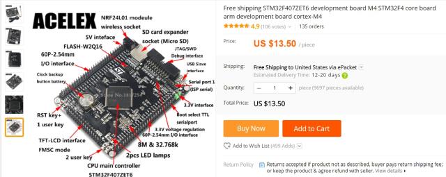

I am very interested on developing with STM32F4xx. In the last few years an immense range of products have been developed around STM32xxx, above all, STM it is a leader in products such as MEMs and Power Devices and other products. STM is investing in the IoT world creating dedicated products.
matherph, Please Can you focus on STM32 + MMBasic?

Another +1 for MMBasic on STM boards.
There is a huge range of STM4 boards at very low prices with lots of Flash and Ram and other features. Stable ADC, DAC, CAN.
No need for special programmers and most boards have USB interface as standard.
https://www.aliexpress.com/wholesale?catId=0&initiative_id=SB_20180303040715&SearchText=stm32f4+board
Very large range of genuine STM factory development and evaluation "Nucleo" boards with separate ST-Link microcontroller programmer at ridiculously low prices.
http://www.st.com/en/evaluation-tools/stm32-mcu-nucleo.html?querycriteria=productId=LN1847
Much more widely used than Microchip PIC32.
By all means retain PIC32Mx170 DIP as a simple single chip platform, but for more advanced applications STMF4 is a better choice in my opinion.
