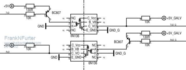

Posted: 08:45am 02 Mar 2018
This circuit worked with up to 115200 bps for me....

Posted: 08:59am 02 Mar 2018
Thanks Frank for that circuit; however, the circuit I need has to have 'physically' separate IR Tx's and Rx's.
My two concerns are 'crosstalk' and speed limit.
Currently unable to try much due to lack of fast IR parts in my spares bin; so more of a theoretical build at the moment!
