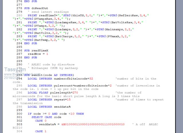

Printing code in colour?
Just printed 13 pages for a school project & it came out B/W.
Didn't actually check my settings, but can MMEdit print colour?
If not is there an easy way to take TBS formatted code to another application & print in colour from there?
Phil.
Posts: 10113
Posted: 04:21am 22 Feb 2018
I'm not Jim, but FILE/SAVE AS RTF works for me.
This outputs a colour RTF file, which I then save as a PDF - job done.

I wanted to know this to, but I must be missing something. Didn't find an option to save as an RTF file so I replaced the .bas with .rtf but it still only opened as a normal B&W file in a word processor.

Click FILE menu at the top left of the window, then moved down to 'Save as RTF', and left-click. Follow your nose from there.

I did experiment with printing line numbers.
I can't remember why I gave up, I think it got too unreliable.
Getting the line-number colours correct is not difficult but the line-wrapping really stuffs up the display.
I don't want to do my own line-wrapping, it would only add more problems.
JimEdited by TassyJim 2018-02-25

Had a little play, notice also that RTF retains the original case of the code as typed.

If you want to print with the keywords in your chosen case, you need to select "Save Keyword CASE" in the Program menu first.
That will permanently alter your file with the format that you chose in Preferences.
It doesn't affect any new typing so you have to run it as required.
The process is too slow to automatically run too often.

If it starts with a digit, &H (hex), &B (binary) or &O (octal), it's a number
27BDFFC0
&HAFB1001C
&B01000011000010000000010001001111
&OA6410015
AFB1001C
anything else is a 'word'
It does cause a few issues with CFUNCTIONs
I will add the option to print line numbers to RTF, but you will have to live with any consequences. My main objection is, you loose the ability to copy and paste back into MMEdit because of the pesky line numbers.
