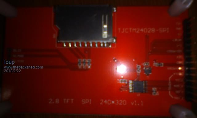

Posts: 2998
Posted: 01:51am 22 Feb 2018

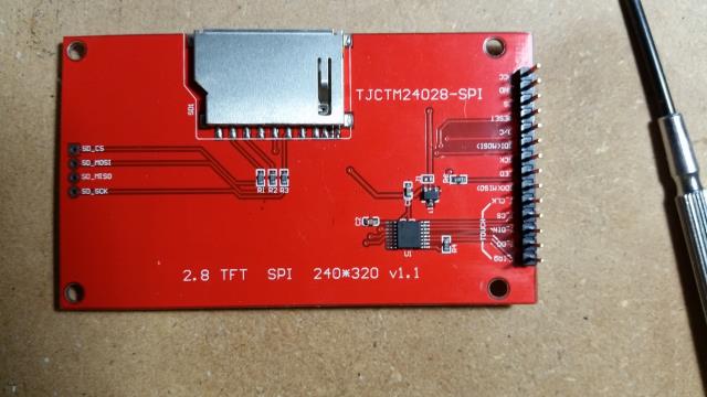

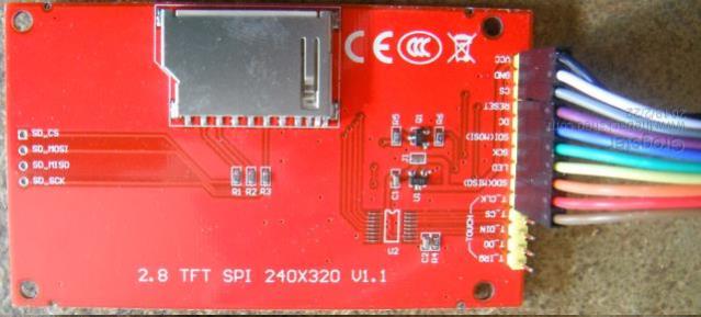

Can you take a photo of the back of the TFT and post it here? There seem to be two main types of TFT module commonly available.
It sounds like a component failure from what you describe - however; I do not believe this has been caused by just a software update. Maybe a closeup of the TFT will reveal a clue . . .

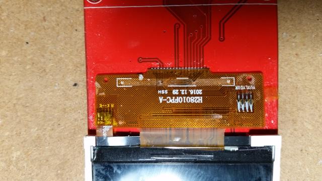

Not sure if the LCD can be removed from the PCB?
Sorry, my phone camera is ordinary.
LouEdited by loup 2018-02-23

That leaves the LCD panel itself or a connection between the panel and it's carrier board. The LCD can usually be pealed of it's carrier but I would only try that if I was going to junk the LCD anyway.
Posts: 2998
Posted: 02:18am 22 Feb 2018
Ok - the transistor on the TFT (just above, and to the right, of the 16-pin Touch controller chip) is a possible cause of your issue.
Does it get warm/hot if the LED backlight is on?
