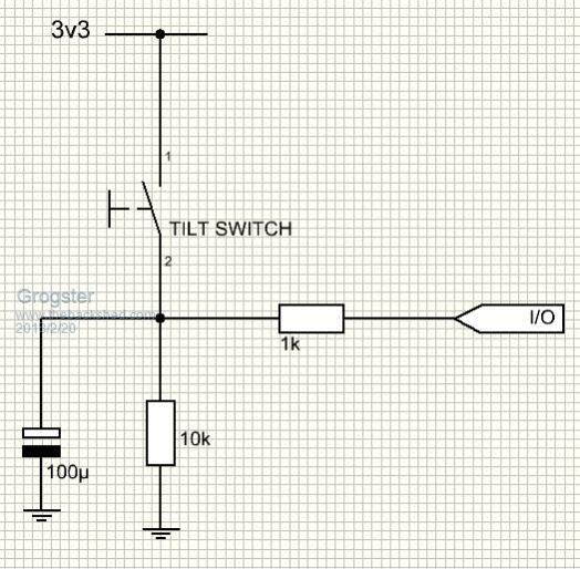

Hi all.
I am playing with the new tilt-switch samples from Digi-Key. The pendulum one seems to work well. I am still trying to work out how to connect to the Rohm one that is 4mm square(the photo-transistor one), as it is QFN-ish, in that you have to reflow solder it in place, as there are no 'Legs' per-se.
Anyhow, this is what I have so far:
Standard arrangement for an I/O pin as an input.
Suppressing the bounce from the tilt-switch with a cap is my first thought, so I have swapped the usual 100n for a big juicy 100uF 6v3 electro cap instead, and the series of pulses are averaged out nicely now to one long pulse about 1 second or so long which is what I want.
My concern is putting a large-ish cap across an input like this. Can I ASSUME that there is no issue here, as the 10k across the cap will discharge it when the tilt-switch is not active, and the 1K series to the I/O pin would limit any serious current from flowing into the input pin from the cap. Yes?
Assumptions are the mother of all.......well...you know the rest of that line.Edited by Grogster 2018-02-21

Grogs, the arrangement you have is not dis-similar to the suggested arrangement for the delayed reset, so I would suggest it is ok.

Hi Grogster
  Grogster said   Hi all.
That should fully protect the input.
Note, the 1K only does "work" if the cap has 3.3V on it and Vcc is dropped to 0V. The max current would be about 3.3mA. Should be OK.
A different problem I can see is when the switch is closed the cap is directly connected across Vcc to Gnd. The charging current can be quite high. I can reset a uMITE on my plug-boards when I add a discharged cap across the Vcc buss.
Lets say the Vcc caps add up to 100uF. When you turn the switch on Vcc will instantaneously drop to 1.67V.
Even if there is more buss capacitance, enough to prevent dropping below 2.3V, there will be a lot of transient noise on the buss.
To prevent this add a small resister in series with the switch.
Lets say the value was 100 ohm the peak current would be about 33mA. Probably enough to prevent problems.

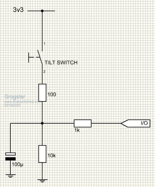

@ redrok: Like this?
I expect that will have an effect on how quickly the cap charges up.
Do you expect that to be a problem?
EDIT: In other words, how long will it take a 6v3 100uF cap to fully charge up if the current is limited to 33mA kind of thing. Charging would need to be quite quick, or the bounce problem might resurface.
I will hook up a 100R resistor in series with the switch now to see.
EDIT: According to this calculator, with a 100R series resistor, the time to charge the cap will be about 0.01 seconds(10mS), so not going to be a problem. I might use 220R instead. That has the effect of lengthening the charge time to 0.02 seconds(20mS), but still so fast as to not be a problem. The 220R+10K will form a potential divider, but the I/O pin will still see 3.2v of the 3.3v, so that should be fine. I will breadboard a test.Edited by Grogster 2018-02-21
redrok
Joined: 15/09/2014
Posts: 209
Posted: 05:34am 20 Feb 2018
Hi Grogster;
Ya, that should do it.
Technically the charge time to the uMITE trip point, about 1/2 of Vcc, the time will be a bit less than the calculated RC value of 63%.
The rule of thumb two 50% is about 1/2 of the time constant.
Therefor the 100R is about .005S, 220 is about.01S.
redrok
