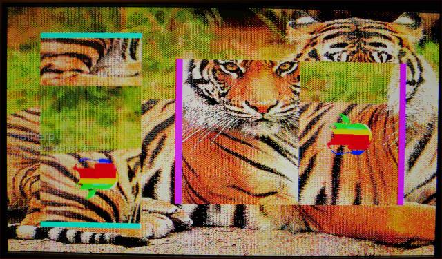

Check the video
Here is the very simple code
option explicit
option default none
cls
load image "tiger640"
sprite load 1,"apple"
sprite load 2,"apple"
dim float x1,y1,x2, y2, i
box 8,98,304,304,2
box 328,98,304,304,2
sprite show 1,200,200,1
sprite show 2,450,200,1
do
for i=0 to PI*2-pi/50 step PI/50
x1=sin(i)*100+160-sprite(w,2)\2
y1=cos(i)*100+250-sprite(h,2)\2
x2=sin(i)*100+480-sprite(w,2)\2
y2=-cos(i)*100+250-sprite(h,2)\2
sprite next 1,x1,y1
sprite next 2,x2,y2
sprite scrollr 10,100,300,300,1,1
sprite scrollr 330,100,300,300,-1,-1
next i
loop
I need to do some tidying and documenting before I release the firmware but hopefully this meets the needs of the "scrolling region" advocates.
The firmware also now includes the ability to scroll an area or the complete screen without "wrapping" the picture and allows the user to specify what colour should fill the vacated area.
The SCROLL NEXT command is new and specifies where the sprite will move to when the next scroll command occurs. This makes the scroll and move a single atomic action so as seen in the video there are absolutely no tearing effects

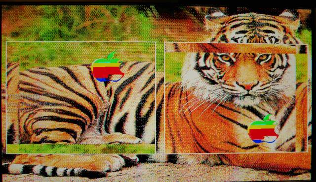

Slowly working though the bugs. Another demo this time showing collision detection. Note how the centre of the screen flashes with a block coloured to indicate which sprites collided.
To get the performance all the manipulations of graphics data have been converted from bit-based to word-based. This has much more convoluted logic for things like handling the sprites when partially off the screen when each colour in the sprite can appear anywhere across a number of words in memory.
  Quote  i notice you have load image... and sprite load.... could the syntax perhaps be tweaked to instead use LOAD sprite...?
I've enabled both
  Quote  is it possible that SPRITE may end up rendering BLIT redundant, or that the functionality of both could be rolled into the one function?
SPRITE and BLIT are synonyms with identical functionality. Some commands make more sense as a BLIT (e.g. scrolling" ) and some as a SPRITE (e.g. "showing")
  Quote  is there any chance you could post the syntax of the SPRITE, BLIT, and other related functions? just the extract from the manual would suffice.
I'm still tweaking syntax as I work more with the code so don't want to release anything yet.
Code for this demo
option explicit
option default none
cls
load sprite 1,"apple"
load sprite 2,"apple"
load sprite 3,"apple"
load sprite 4,"apple"
dim float x1,y1,x2, y2, i, crash=0
box 8,98,304,304,2
sprite show 3,170,200,1
sprite show 1,200,200,2
sprite show 4,400,200,2
blit read 5, 310,240,20,30
do
x1=sin(i)*230+220-sprite(w,2)\2
y1=cos(i)*230+250-sprite(h,2)\2
x2=sin(i)*230+420-sprite(w,2)\2
y2=-cos(i)*230+250-sprite(h,2)\2
sprite next 1,x1,y1
sprite next 2,x2,y2
' sprite move
sprite scrollr 10,100,300,300,2,2
if sprite(s)<>-1 and crash=0 then
if sprite(c,0,1)=1 then box 311,241,18,18,,rgb(red),rgb(red)
if sprite(c,0,1)=2 then box 311,241,18,18,,rgb(blue),rgb(blue)
timer=0
crash=1
endif
if sprite(s) = -1 and crash = 1 and timer > 500 then
blit write 5,310,240
crash=0
endif
sprite scrollr 330,100,300,300,-2,-2
next i
loop
Background and sprite
2018-02-05_005226_apple.zip Edited by matherp 2018-02-06

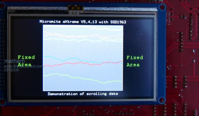

The scrolling region capability also works nicely on the SSD1963 to create a real time chart
Watch another boring video here
Again the new functionality makes the code very simple and I hope I'm getting to the end of the bugs - found another bizarre one this morning - right hand end of a sprite not displaying when left hand x coordinate satisfies x= 16+ n*32
const scrollxstart=100, scrollxwidth=280,newpoint=scrollxstart+scrollxwidth-2
const scrollystart=20,scrollyheight=232, scrolldirection=0
dim integer i, j, rp=130, bp=100, yp=160, wp=190, cp=70, xp=40, zp=220
cls
text scrollxstart+scrollxwidth\2,0,"Micromite eXtreme V5.4.13 with SSD1963",C,1,,rgb(white),rgb(black)
text newpoint+16,scrollystart-13+(scrollyheight\2),"Fixed",,2,,rgb(green),rgb(black)
text newpoint+16,scrollystart+13+(scrollyheight\2),"Area",,2,,rgb(green),rgb(black)
text 10,scrollystart-13+(scrollyheight\2),"Fixed",,2,,rgb(green),rgb(black)
text 10,scrollystart+13+(scrollyheight\2),"Area",,2,,rgb(green),rgb(black)
text scrollxstart+scrollxwidth\2,scrollystart+scrollyheight+5,"Demonstration of scrolling data",C,1,,rgb(white),rgb(black)
BOX scrollxstart-1,scrollystart-1,scrollxwidth+2, scrollyheight+2,1,rgb(white),rgb(gray)
do
' scroll an area defined by the x-y coordinates of the top left point
' the width of the area to be scrolled
' the height of the are to be scrolled
' the scroll driection
' define the colour of the scroll background
rp=nextpos(rp)'get the new data points
bp=nextpos(bp)
yp=nextpos(yp)
xp=nextpos(xp)
zp=nextpos(zp)
wp=nextpos(wp)
cp=nextpos(cp)
box newpoint,xp,2,2,1,rgb(yellow) 'write them to the space left
box newpoint,rp,2,2,1,rgb(blue)
box newpoint,yp,2,2,1,rgb(red))
box newpoint,bp,2,2,1,rgb(green)
box newpoint,wp,2,2,1,rgb(magenta)
box newpoint,cp,2,2,1,rgb(cyan)
box newpoint,zp,2,2,1,rgb(white))
blit scrollr scrollxstart,scrollystart,scrollxwidth,scrollyheight,-2,0,rgb(gray)
loop
function nextpos(d as integer) as integer
nextpos=d+(rnd()*4)-2
if nextpos<=scrollystart then nextpos=scrollystart+1
if nextpos>=scrollystart+scrollyheight then nextpos=scrollystart+scrollyheight-1
end function

Another demo
Watch it here
I've implemented sprite mirroring as a new parameter on the sprite show command
SPRITE SHOW {#}n, x, layer {,orientation}
Displays sprite n on the screen with the top left at coordinates x, y. Sprites will only collide with other sprites on the same layer, layer zero, or with the screen edge. If a sprite is already displayed on the screen then the SPRITE SHOW command acts to move the sprite to the new location. The display background is stored as part of the command such that it can be replaced when the sprite is hidden or moved further. The orientation is an optional parameter, valid values are:
0 - normal display (default if omitted)
1 - mirrored left to right
2 - mirrored top to bottom
3 - rotated 180 degrees (= 1+2)
I've also implemented
SPRITE CLOSE ALL
This closes all sprites and frees up all used memory. It does not change the screen.
If I can get away without any more requirements I should be able to release the firmware soon as it is now starting to become pretty stable
Basic program for the above demo demonstrates the new functionality + collision detection interrupt handling. Note how the collision interrupt has to do something to clear the "collision" - in this case a scroll in the opposite direction. Otherwise the interrupt will re-occur when the second unrelated scroll is actioned.
option explicit
option default none
const leftbar = 1, rightbar = 2, topbar=3, bottombar=4, rightapple=5, leftapple=6
dim integer moveright=1, movedown=1
box 250,100,10,280,,rgb(magenta),rgb(magenta)
box 50,50,150,10,,rgb(cyan),rgb(cyan)
blit read leftbar,250,100,10,280
sprite copy leftbar, rightbar, 1 'make one copy
blit read topbar,50,50,150,10
sprite copy topbar, bottombar, 1 'make one copy
load sprite rightapple,"apple"
sprite copy rightapple,leftapple,1 'make one copy
sprite interrupt collision
blit show rightapple,300,200,0
blit show leftapple,100,200,0,2
blit show leftbar,250,100,1
blit show rightbar,580,100,1
blit SHOW topbar,50,50,2
blit SHOW bottombar,50,420,2
do
if moveright then
sprite scrollr 259,100,322,280,2,0
else
sprite scrollr 259,100,322,280,-2,0
endif
if movedown then
sprite scrollr 50,59,150,362,0,-2
else
sprite scrollr 50,59,150,362,0,2
endif
loop
sub collision
local integer i, c(10), j
if sprite(S) = 0 then 'collisions caused by scroll
j=sprite(c,0)
for i=1 to j 'store the collisions because a clearing scroll move will clear them from the list
c(i)=sprite(C,0,i)
next i
for i=1 to j 'now process them
process_collision(c(j))
next i
endif
end sub
' get details of the specific collisions for a given sprite
sub process_collision(S as integer)
select case S
case leftbar
sprite scrollr 259,100,322,280,2,0 'make a move to clear the collision
sprite show rightapple,sprite(x,rightapple),sprite(y,rightapple),0,0 'normal orientation
moveright=1
case rightbar
sprite scrollr 259,100,322,280,-2,0 'make a move to clear the collision
sprite show rightapple,sprite(x,rightapple),sprite(y,rightapple),0,1 'mirror the sprite
moveright=0
case topbar
sprite scrollr 50,59,150,362,0,-2 'make a move to clear the collision
sprite show leftapple,sprite(x,leftapple),sprite(y,leftapple),0,3 'rotate the sprite 180 degrees
movedown=1
case bottombar
sprite scrollr 50,59,150,362,0,2 'make a move to clear the collision
sprite show leftapple,sprite(x,leftapple),sprite(y,leftapple),0,0 'normal orientation
movedown=0
case else
end select
end sub
Edited by matherp 2018-02-08
