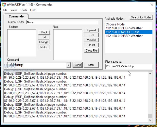

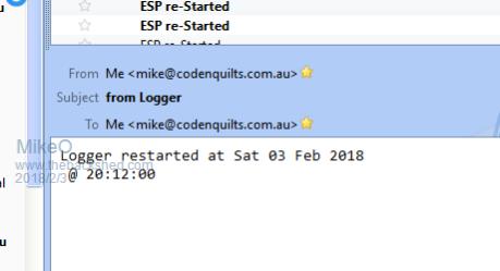

Using the 8 port controller PCB I posted recently I just completed a simple wifi logger system, this is not a complete project more a proof of concept. I used matherp's cfunctions for serial flash together with my UMite to ESP8266 routines which allow UDP network transmissions to a Windows PC. It is also possible to send email from this combination which could be used for various notifications like, low power supply, sensor warnings out of range, controller resets etc. A proper project would probably have a Java app for dumping the data to a file by day and month etc.

if flag(4)=1 then
sendemail ("from Logger","Logger restarted at " + wholedate$ +" @ "+time$)
flag(4)=0
end if

case "uMdump"
print "dump flash"
flag(3)=1
f.pos%=1
end select

'open Flash and send via UDP
sub readflash
local d$
d$=f.read$(f.pos%)
print d$
if d$<>"" then
xbsend "udp.send:|"+dest$+"|flash|flash.txt|"+d$
WaitforReady 'reset flag
f.pos%=f.pos%+1
else
flag(3)=0
xbsend "udp.send:|"+dest$+"|flash-Close|"
end if
End Sub
sub sendemail(esub$,ebody$)
print "Sending email..."
xbsend "email:mike@codenquilts.com.au:mike@codenquilts.com.au:"+esub$+":"+ebody$
pause 3000
end sub
