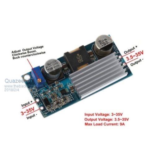

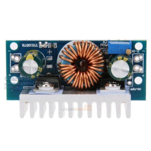

You can see if these will do.
150W DC-DC Boost Converter 10-32V to 12-35V 6A Step Up
Seen them when looking around ebay for a 3.3V to 9v or adj module.

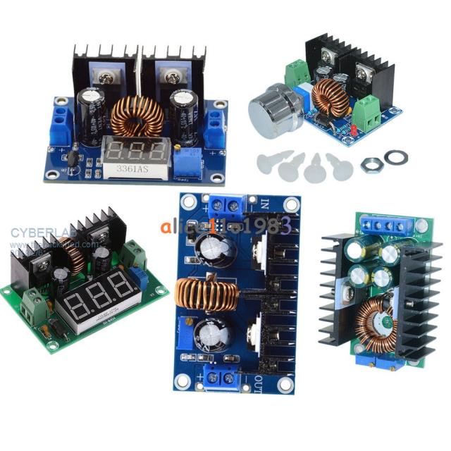

hello all, I think you need a step down converter, for example if you use the first boost converter of the image from Quazee137 has these features 150W DC-DC Boost Converter 10-32V to 12-35V and you feed it with 14.5 volts your output will be 14.5 to 35v instead if you use a Step Down Buck Converter 7-40V To 1.2-35V and you feed it with 14.5 your output will be approximately 14 down to 1.2v and this model has a nice voltmeter.
https://www.ebay.com/itm/XL4016-Step-Down-Buck-Converter-7-40V-To-1-2-35V-Power-Module-DC-CC-8A-200-280W/263355214002?ha sh=item3d5131a8b2:m:mlat9DzlEK8cJ0M-kxaR2dQ
