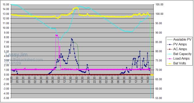

This is the output from a solar powered radio repeater I look after. The readings are done my a micromite and it keeps the last 2 days so I can retrieve at my leisure.
(very cloudy the last 2 days)

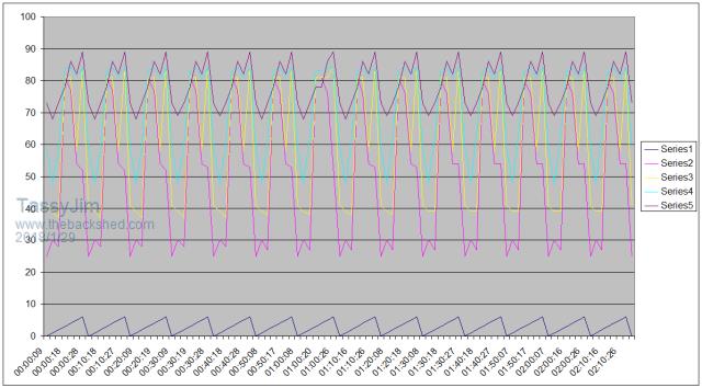

I did a quick and nasty based on your data and found that the cyclic nature of the data produces poor charts for a full day.
This is the first 100 points
And this is the spreadsheet that did it. I left the chart at 100 points for now.
Try pasting another day over the first column. Provided your data stays at fixed length, it should work out OK
