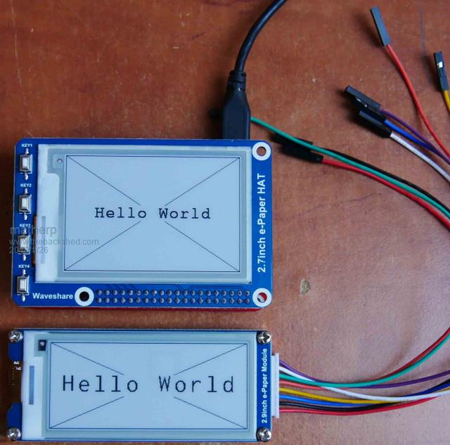

Attached are display drivers for the 2.7" and 2.9" E-ink displays.
These are written entirely in Basic using the new "User" driver capability in the latest release of the MM2, MM+ and MMX firmware.
The displays are S.....L.....O.....W
A screen refresh on the 2.9" display takes just less than 3 seconds and somewhat over 5 seconds on the 2.7" display (note this is not significantly affected by the Basic code - re-writing in C wouldn't help). Also the displays flash from a normal image to an inverted one and back to a normal one as they refresh.
but they are Very low power
As seen in the picture the 2.9" display is drawing 0 amps as it isn't connected.
When in circuit is draws about 0.7mA. I haven't measured the 2.7" display but I assume it is similar. The 2.7" display also has 4 switch inputs, useful for controlling an application.
The 2.7" display is mounted on one of my MM+ HAT stands (the red one). and the pinout in the code suits this layout but can be altered for any other layout. NB for the MM2 you also need to change SPI2 to SPI in the code (4 places)
Despite the adverts the displays are orientated in portrait mode:
176 x 264 for the 2.7" display
128 x 296 for the 2.9" display
I'm using the Rotated Text facility on the MM+ to print the text in Landscape (MM+ manual - page 27).
There a number of other E-ink displays available in various sizes and it should be easy to modify the code to suit (just look at the supplied Arduino "init" routine for the likely differences)

2.7" display
' driver for 2.7" e-INK display
' The MMBasic graphics commands update a memory image of the display and the user should call REFRESH

userdisplayinit(0)
line 0,0,mm.hres-1,mm.vres-1
line mm.hres-1,0,0,mm.vres-1
box 0,0,mm.hres,mm.vres
text mm.hres/2,mm.vres/2,"Hello World",CMU,4
refresh

I used the following pins.
CLK = 25
DIN = 3
CS = 2
DC = 17
RST = 18
BUSY= 9
I changed the Constants to these pin nos. and changed the 4 instances of SPI2 to SPI.

Ok I have now loaded the file into an E-64 but now get an error...
  Quote  [297] i=SPI2(databyte)
Error: Not open
Paul.
Edit..
Thinking there maybe a problem with SPI2 I changed to SPI1 and it works OK.
I loaded it into the library, now how do I use it, do I have to delete the lines
  Quote  userdisplayinit(0)
text mm.hres/2,mm.vres/2,"Hello World",CMU,5
refresh
end
Edited by palcal 2018-03-12
Posted: 08:27am 11 Mar 2018
  Quote  I loaded it into the library, now how do I use it, do I have to delete the lines
You need the line
userdisplayinit(0)
at the top of your program as this initialises the display.

I have it working OK but it is much slower than you stated. Using this small piece of code,
timer=0
userdisplayinit(0)
text mm.hres/2,mm.vres/2,"Thanks Peter",CMU,5
refresh
print timer
It takes 18 seconds to display but the timer is only reading 2655 ?
Paul.
Edit.... Does the timer stop while the library code is executing?Edited by palcal 2018-03-13
