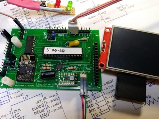

I have started a new thread but this should perhaps be read in conjunction with my post Headless MX170 Controller as this PCB sort of morphed out of the previous post/project as one all on its own.

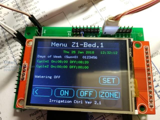

After three iterations the ver 1.3 board is there i think has all the functions and no more circuit errors (I hope). Shown below is the latest PCB fully populated with all functions tested OK.
LCD working with Touch - OK
8 Port Ext with sw - OK
Wi-Fi with sw - OK
Flash Ram (matherp sw)- OK
SD-Card on LCD (matherp sw)- OK
ISCP - OK

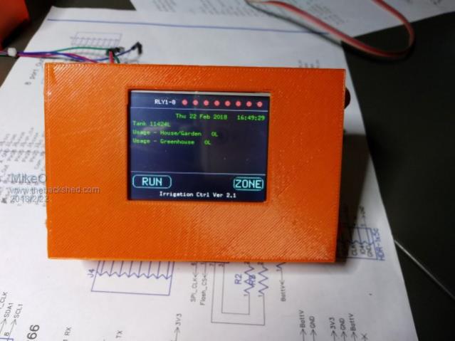

3D printed enclosure for the 8 port controller.
This is designed for the 2.4" LCD display, I don't have one to try but the backpack boards with a 2.4" LCD should also fit OK. The are two versions a plain box and the same thing with Lugs/tabs so that it could be mounted vertically on a panel etc.
3D stl files are on my server under downloads
