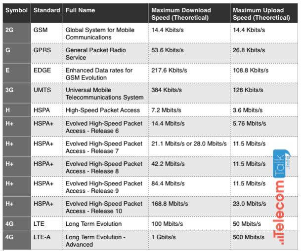

I have had this graphic that I collected somewhere for a while now. Might be useful to others:
2G is possibly as high as 14K which to be honest is perfectly fine for exchanging a few hundred bytes every now and then (2400 is most likely fine if the size and rate is low enough).
Edited by CaptainBoing 2018-01-28
Posts: 10109
Posted: 01:18am 28 Jan 2018
A very useful chart. Thanks for posting.

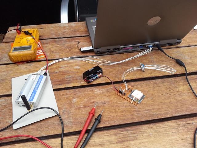

@Grogster
I have a few of those GSM modems branded as 'wavecom' they do work really well. I did some experimenting with them a few years ago and wrote a small micromite program that responded to a SMS location request to create a google maps URL that was constructed using latitude and longitude taken from a GPS. It then sent the URL in a SMS back to the sender, it worked a treat.
I still have a few of these wavecom units new in boxes, since 2G got switched off here last year they are aren't much use to me now. I was considering offloading them on Ebay. If you're insterested I could send you a couple. Perhaps you'd be interested in a trade for some of those nice micromite PCB's you make? Note that the modems don't come with an antenna (these can be sourced elsewhere cheaply however) but they do come with the required plug for power.
-Heidelberg
Edited by Heidelberg 2018-01-30

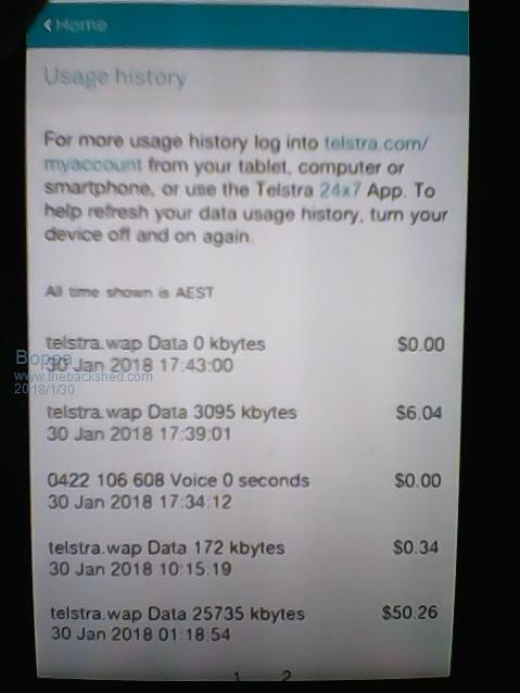

I'm not impressed with helstra- bought a $50 longlife sim to put into an old phone for family, put it on charge and just got an sms from them, its out of credit...
Whaaa????- havent even used it yet???
I didnt turn off the data- somethings updated itself and bingo $50 gone (plus most of the $10 free they give you with the new sim)
check out that last one tho- on the longlife plan, 25mb is $50.26
Ouch indeed

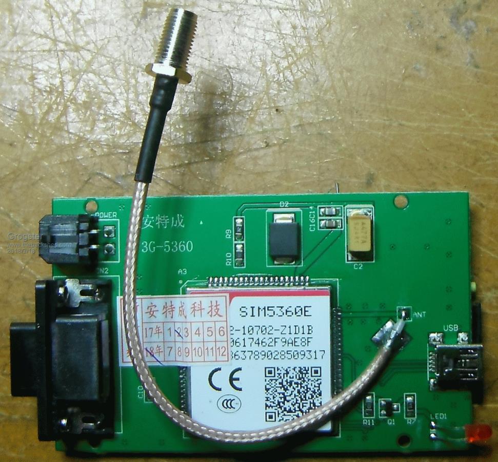

This unit is based on a SIM5360 from SimCom and is a dual-band 3G compatible unit. My one is the 5360(E), which works on the 3G bands here in NZ. (UMTS 900MHz and UMTS 2100MHz)
For any New Zealand members reading this, I can confirm that these units can talk to the 2-degrees 3G network, so should therefore work on any of the primary providers.(Spark/Telecom, 2-degrees, Vodafone). This unit does not support 4G/LTE networks.

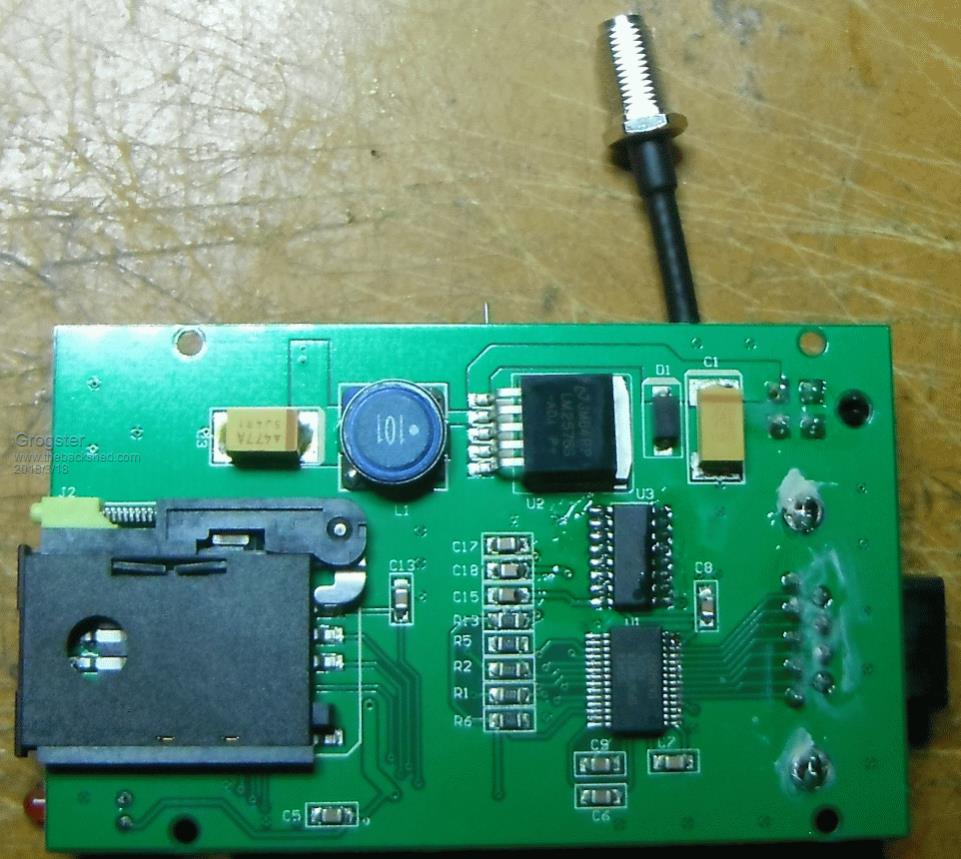

The unit is encased in an attractive aluminium die-cast case, measuring 86mm long, 54mm wide and 25mm deep. The single red LED on the side of the case is steady on when you first power it up, then it starts blinking at 1Hz once it has connected to the 3G network. That is very useful to have for field testing - just lets you know the unit has an active connection to the cell-phone network without you needing to connect anything up.
Internal shots of the PCB:
Neat and tidy, and all perfectly acceptable there.

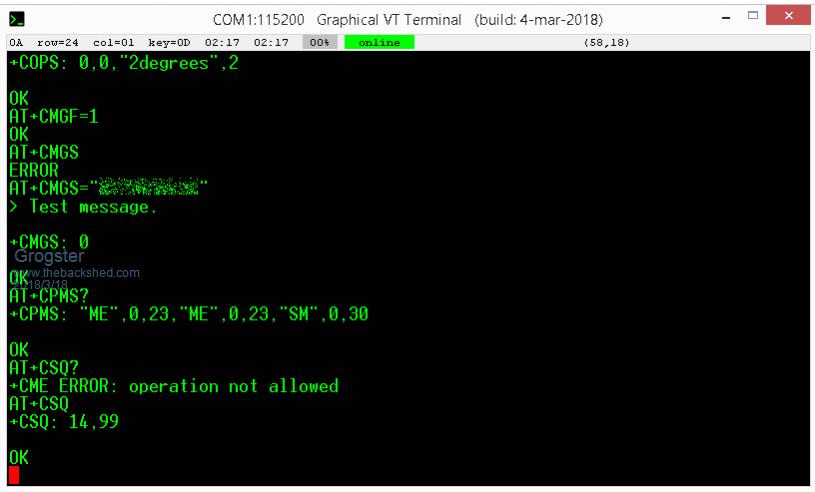

The unit accepts a standard-size SIM card, and has a nice little card-tray that you access by pressing in an 'Eject' button. The default baud-rate 115k2, but you can change that to anything from 300 baud to 4Mb! The MM UART is easily capable of 115k2 baud, so that is what I plan to use it on. (via a MAX3232) One less thing to have to configure.
The full AT command set is very well documented by SimCom at 622 pages - bloody hell! This unit can do WAY more then just SMS messaging, which is all I want it for. The unit DOES NOT have any connections for a microphone or earpiece externally, as it is designed as a data-node device more then for voice traffic. The unit could probably be hacked without too much trouble to support those connections if you were desperate enough.
About the only thing I WILL be changing, is the supplied plug-pack power-supply. I will be feeding the unit from the 12v UPS running the system. I have no idea of the quality of the supplied power pack, so won't be using that, although I am right now for the purposes of testing. It didn't explode when I switched it on, so there's that.....

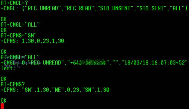

EDIT: Reading messages is also easy. By default, the unit uses the SIM card for message storage of up to 30 messages.
Select the SIM card storage: AT+CPMS="SM"
Read all messages: AT+CMGL="ALL"
+64 is the start of my cellphone number, but I have scrambled the rest of my number for privacy. But that was my test message back to the unit.
Deleting messages is done with AT+CMGD, but I have not bothered to do that, as this node is an outgoing only - it just sends SMS, and will ignore any incoming SMS. I was just playing. Edited by Grogster 2018-03-19
