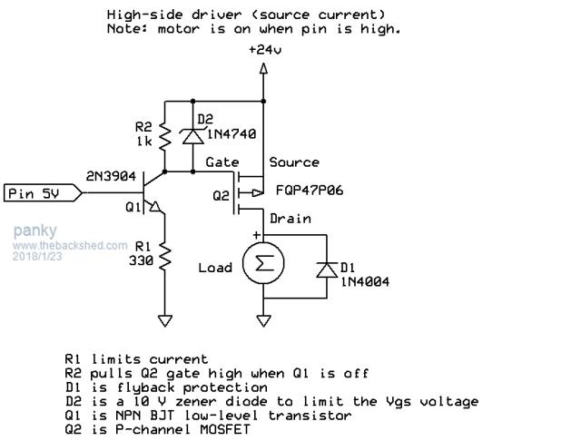

This circuit might be the workaround - a few more components but would let you use the MOSFET above.

Posted: 03:33am 23 Jan 2018
Using the above circuit, after deleting the zener, Vgs will be very close to (Vb-.6)* R2/R1
For example if you want 10v gate to source and you have 3.3v input, then R2/R1 will be 10/(3.3-0.6)=3.7 .This would be satisfied by R2=1k2 and R1=330R.
This relationship is mostly independent of the supply voltage.
I wouldn't use this for high speed pwm, but it would be fine for 1kHz or less.
If it is keeping you awake at night, add the zener anyway.

Just to clarify for folks here, the example diagram that panky posted is NOT what I am doing. I am trying to find a MOSFET to act as a high-side switch(with helper transistor) for the battery charging switch thing I discussed in another thread. This is where I want to be able to turn OFF the battery charging under MM control, once a certain time or battery voltage has been achieved, to prevent overcharging. Although, with a trickle-charging arrangement, I might just be making things overly complex for myself for no good reason....

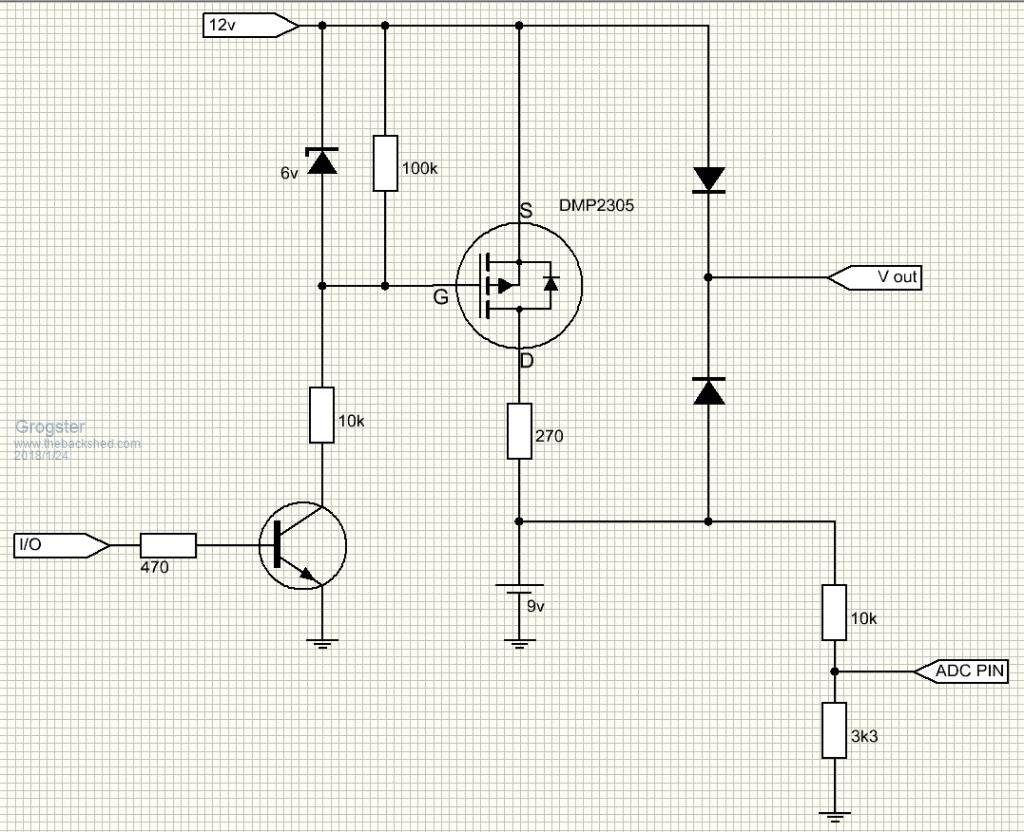

@ Rob: Is this the kind of idea you are talking about....

grogster: that is exactly what i'm talking about.
looking at panky's circuit, i think it may also work. Q1/R1 form a constant-current sink, drawing (3.3-0.6)/330 = 8mA when 3.3v is applied to the base of Q1. when the base of Q1 is low (less than 0.6v), no current flows.
the only disadvantage of this arrangement is that IF the base of Q1 is held high while there is no collector load for Q1 (ie, R2 and D2 missing), then the 8mA gets drawn from the micromite's control pin and flows down through Q1's BE junction.
R1 and R2 could probably be scaled up by a factor of 10 (ie, R1=3k3, R2=10k) to reduce the current to 800uA.
note that below a few milliamps, zeners may not regulate particularly well, but in these sorts of applications that doesn't really matter.

Awesome. Thanks a bunch. That means I can use one of the 2305's I have here, as I have several hundred of them in SOT-23. I'm not entirely sure why I did not think of using a zener on the gate myself, but my little grey cells sometimes......
