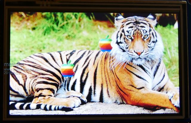

This release plays with some ideas for Sprites building on the existing BLIT functionality which has also been slightly simplified/improved. Sprites are full colour and of any size and shape. SPRITE/BLIT images can be displayed partially off the screen, this was not previously the case for BLIT on the MMX, and I believe the MM+, where partially off screen images were corrupted.
The commands and function SPRITE and BLIT can be used interchangeably

The code for a very simple demo is attached
Option explicit
option default NONE
dim integer i
DIM INTEGER iw, ih
' load sprite
BLIT LOAD #1,"apple"
BLIT LOAD #2,"apple"
iw=BLIT(#1, W)
ih=BLIT(#1, H)
'create a background
load image "tiger800"
dim n%,m%, x1%=rnd()*(mm.hres-iw), y1%=rnd()*(mm.vres-ih), x2%=rnd()*(mm.hres-iw), y2%=rnd()*(mm.vres-ih)
dim x1o%=-1, x2o%=1, y1o%=-1, y2o%=1
dim s%=8
blit show 1, x1%,y1%
blit show 2, x2%,y2%
