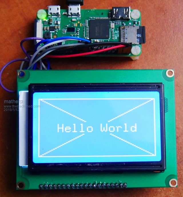

This fixes a bug in the PEEK command and also implements the USER display driver capability of Geoff's version 5.4.09. In addition it includes a new font #7 which is a small 6x8 font ideal for smaller displays. NB the Pi-cromite does not support loadable fonts.
This is a huge advantage on the Pi-cromite where we can't have CFunctions. MMBasic is very fast on the Pi-cromite and drivers in Basic perform well
The picture shows an ST7920 based 128x64 display (QC12864B) being driven by a SPI user driver on a Pi Zero-W. The code is attached below and will also work unchanged on any of the Micromites (other than adjusting the pin numbers)
