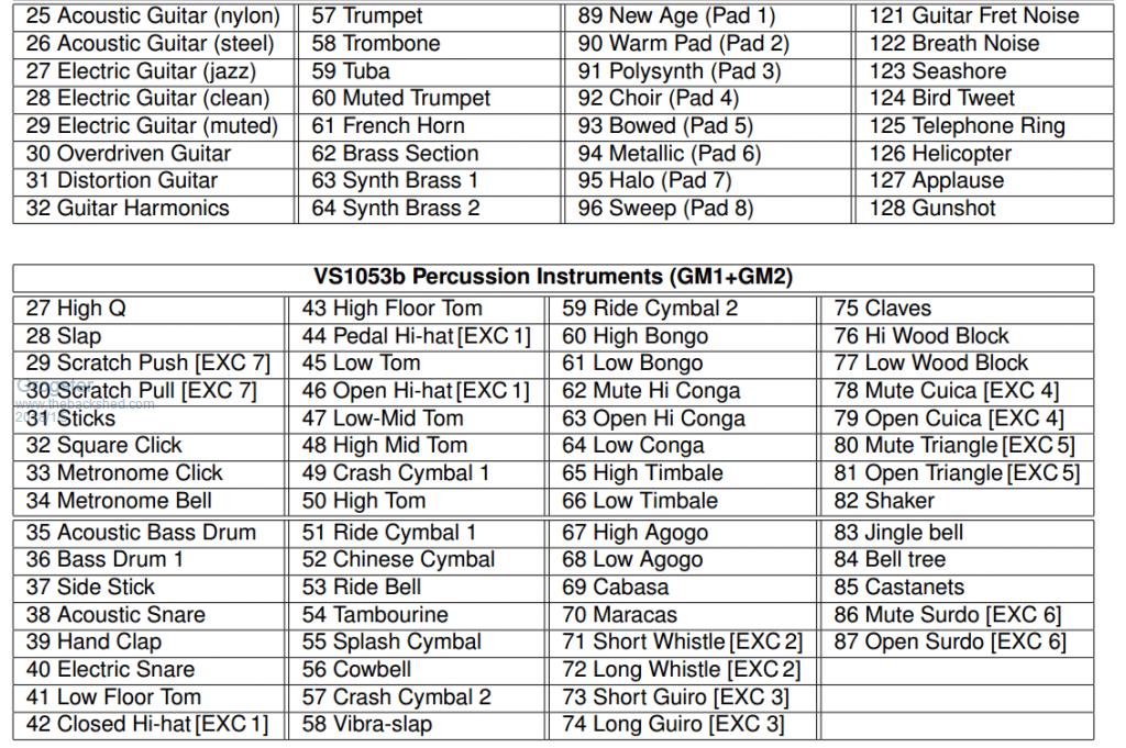

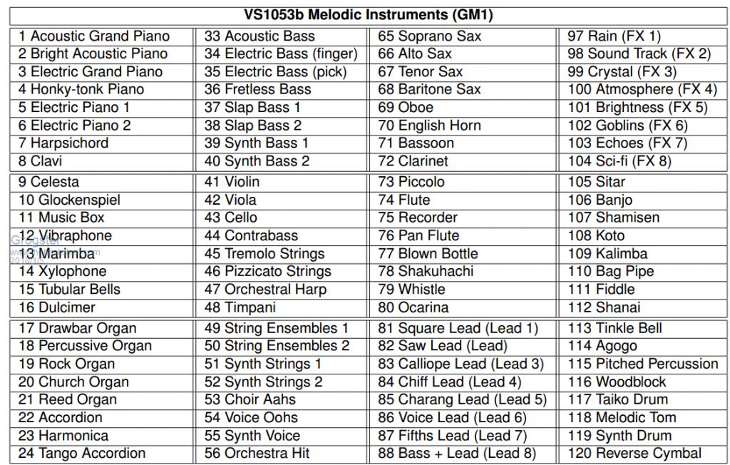

The 1053 gives you access to the following instruments and also a good selection of drum sounds, so a MM-based drum-machine might be coming(using other MM input pins for sensor pads).....
Do any of the technical boys and girls here see any OBVIOUS problem with this concept as it sits now? Perhaps other members have even better MIDI synth chips they know about? Please post if you do.
