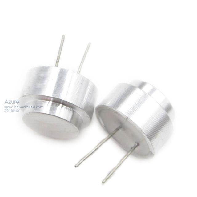

Has anyone had any experience with this sort of Ultrasonic Sensor Integrated Transceiver Waterproof Diameter 16MM 40KHz
Want to know more about circuits using units for transmitter and receiver like the ones where there are 3 or 4 in car a bumper warning system.
They look like this:
