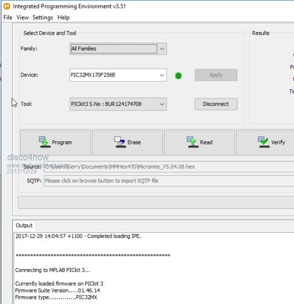

Hi Bob,
Do you have a PICkit 3 adapter connected. If so you need to selected it as the Tool and then connect.The target should be powered up, but have LCD unplugged as it may interfere with some to the pins used for programing. Sometimes I have had the close the MPLAP IPE and reopen before it will connect.
If you don't have a PICKit 3 then have a look here for and alternative programmer and method.
ASCII-ICSP-kit-for-Micromite-and-other-PIC32-MCU-s
Gerry

Yes my mistake there. You will need the the PICPROG32.exe in lieu of the MPLAB IPE though. The program and a GUI for it are available from here
PICKIT3 and MPLAB IPE go together. The builtin 16F1455 uses the PICPROG32 utility. I have not used it but I think there may be a button to get it into program mode.
Hope this helps
Gerry
