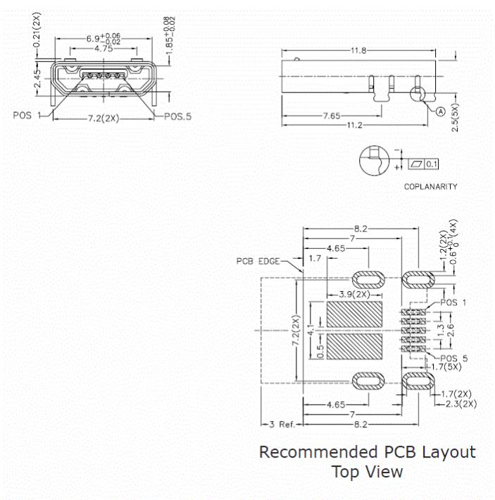

I am trying to get a new 64 pin 470 based PCB going and can't seem to get the USB
to respond... Programed with the new v5.04.08 firmware released today...
I am using a micro USB type connector as shown here
I hooked it up assuming the pin out would be:
Pin 1 - VBUS
Pin 2 - D-
Pin 3 - D+
Pin 4 - N/C
Pin 5 - GND
Frame - GND
The PCB is being powered OK from the USB port and programed OK on the PicKit-3
I have D- connected to pin 36 and D+ connected to pin 37 of the 64 pinner...
As a test, I hooked up a USB to serial converter and TeraTerm does talk OK...
Things seem to be connected correctly on the PCB.. But no go on the MM USB...
So, I wanted to check with someone here to make sure I selected the correct
pinout for the USB connector footprint in DEX...
Thanks for any feedback on this..!!
Posts: 10043
Posted: 01:24am 28 Dec 2017
Pinout seems fine to me, so there should be no problems there. I just checked with Mr. Google's images, and that all seems fine.
On the 64-pin MM+ chip, do you have pin-34 connected to the USB 5v line?
I think the MM+ needs to have that connected, so the MM+ chip knows you have plugged in the USB cable. If NOT connected, I don't think USB will respond.....

Yep.. I got pin 34 as well as pin 33 on the VBUS line...
I was going to use 33 as an easy way to check if the user
has the cable plugged in the housekeeping loop...
You are correct in that I have not properly checked if the
+5v is actually there... will do...
I did see about 3 something volts on the D- line and 0v on D+
(whatever that means)...
So, OK... Thanks again for the pinout check..!!
One more thing off the list..
EDIT: - Voltage Check - OK... But Yikes, would you believe bad cable..!!
Sho nuff.. - All seems good now...! OK... Onward and upward..
(you don't think I could have used a "charge only cable)
Hey, it's zonk... Anything is possible... Didn't know I had one.. Hummm
