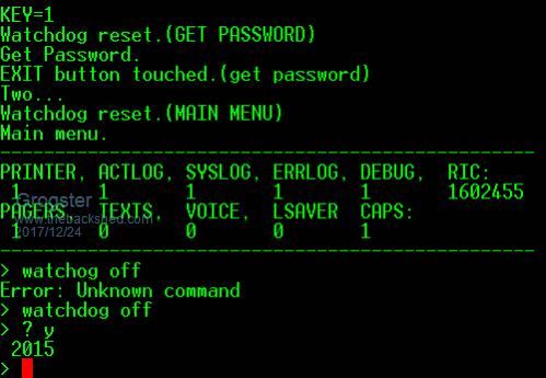

Print "One..."
Print "Two..."
ON Y goto START,DATABASE_EDITOR
I get the following output on the console:
....note how the code is NOT printing the "One..." line, but it IS printing the "Two..." line.
This also takes me back to the main menu. If I CTRL-C at that point, and ask the console for PRINT Y, it gives it back as 2015, which it most certainly should not be.

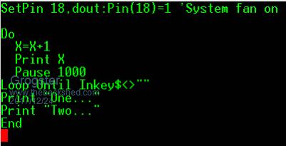

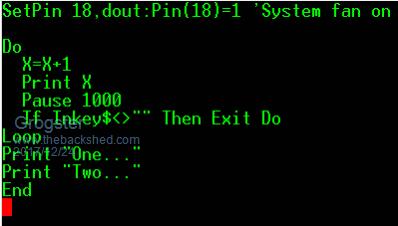

Here is some demo code:
RESULTS:
The result is that "Two..." is printed, and "One..." is totally ignored.
Seems to be that the first line following the LOOP command, is being skipped?
EDIT: It's related to the EXIT DO command.
If I remove the If Inkey$<>"" Then Exit Do line, and change the LOOP line to read Loop Until Inkey$<>"", then the code works!
Therefore, in my original code posted above, the interpreter is not seeing or otherwise not executing the ON command at all(because it is right after the LOOP command) - and just starts running the next routine below it, which is the database editor routines....Edited by Grogster 2017-12-25
