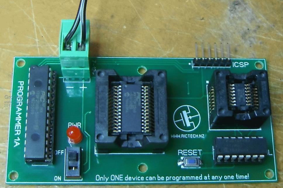

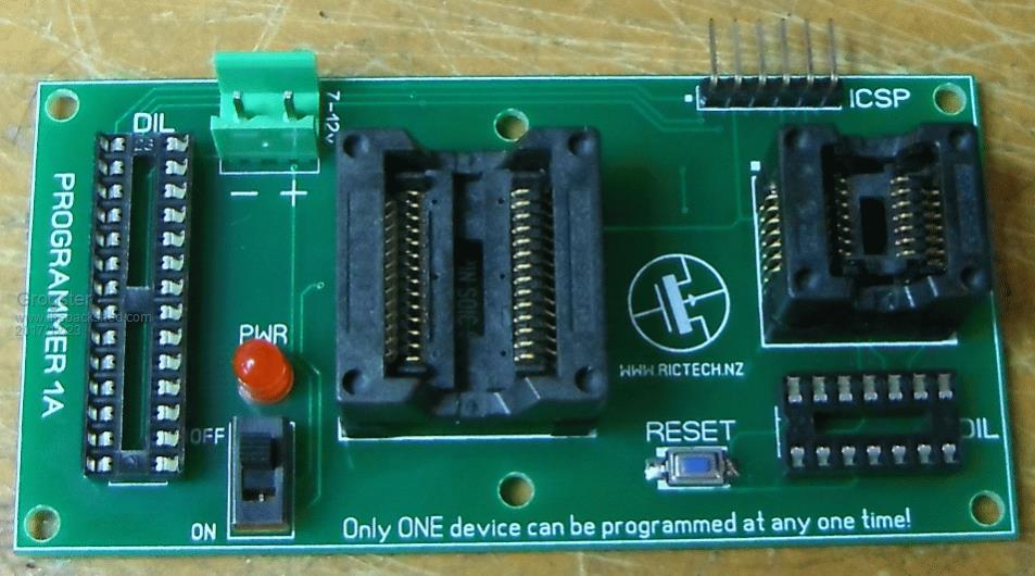

This is what I built myself for Christmas to make programming MicroMite's easier:
It can program any ONE device at any one time, but can program the standard 28-pin chip and the 1455 USB chip in DIL and SOIC flavours. The last photo shows the board fully-loaded with all chips, but you can't actually program it like that, that is just so you can see mainly the SOIC chips loaded in the sockets.
I plan to offer programmed chips on the website next year, but probably only the DIL ones. The SOIC sockets are just to make my life easier for assembly stuff, but if there is any interest, I could keep a small stock of programmed SOIC chips. I see the breadboard-friendly DIL chips being more popular, but that is just me.
If anyone is interested in a constructors pack for this thing, let me know and I will compile one and upload it to my website sometime over the Christmas break.
