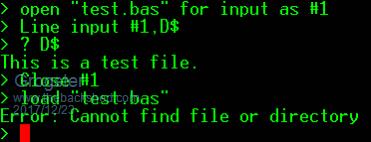

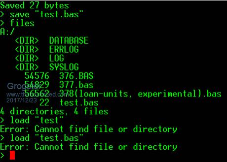

I can't get the latest version to load ANYTHING from the SD-card.
I just keep getting an error that it 'Cannot find file or folder.'
Is anyone else seeing this problem?
EDIT: 64-pin MM+ chip - I should probably mention that....

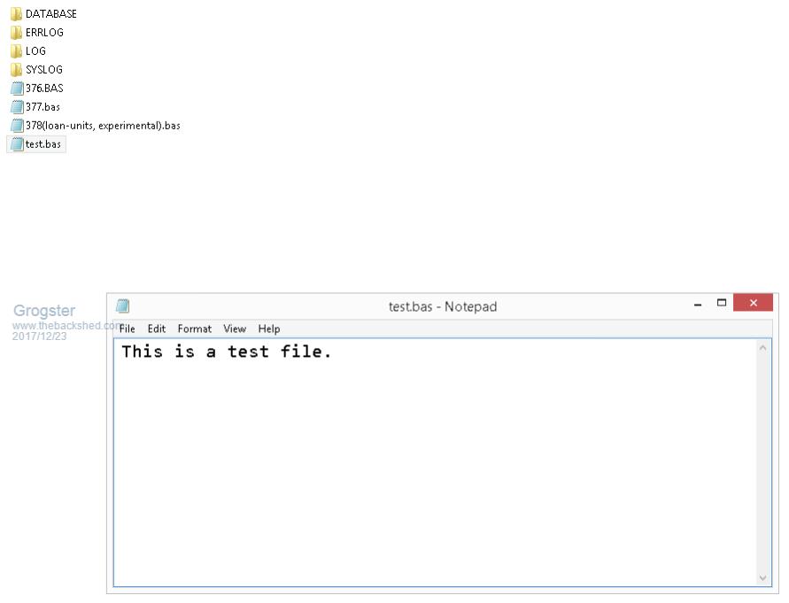

EDIT: Windows sees the test file just fine when I put the uSD card in, so the MM+ is writing the file just fine so it would seem, but it won't LOAD anything.....
EDIT: You can OPEN files for read, but you just can't LOAD them:

Drat, there is a bug in the LOAD command... thanks Grogs for reporting it and matherp for pointing out where the bug is in the source.
Rather than make a whole new release I have simply updated the hex file on my website. So, if you have downloaded the V5.04.07 firmware and are using the Micromite Plus version please go back and download it again (clear your browser's cache first). The only file that has changed is Micromite_Plus_V5.04.07 and it now has the date of 24 Dec 2017.
