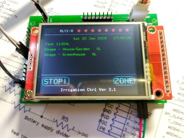

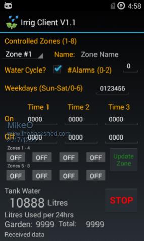

Hi to all the Forum, I would like to wish you all Merry Christmas and all the best for the New Year.

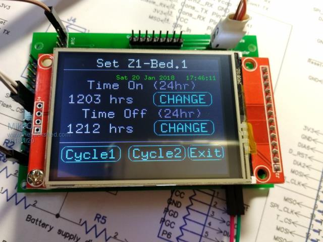

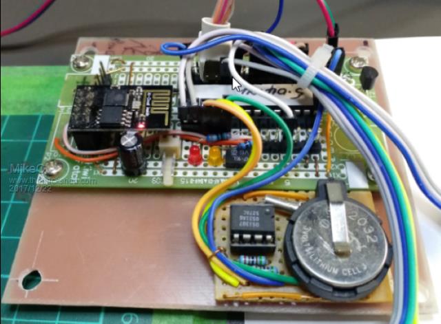

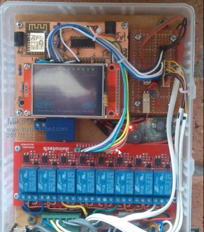

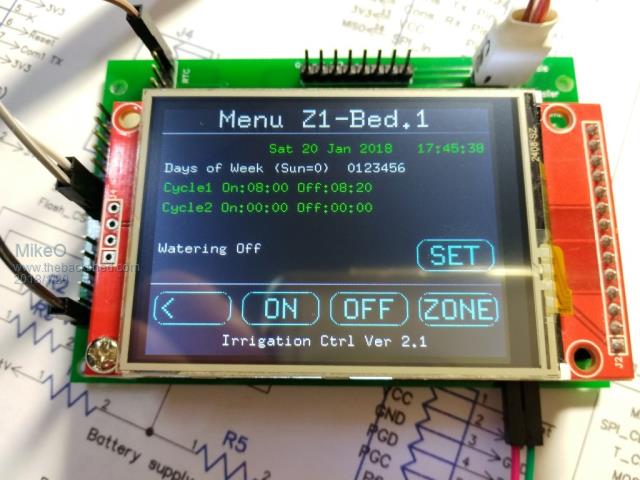

I am currently just completing the a rework of my original MX170 controlled Irrigation System. It controlled 8 Zones (garden Bed watering, Greenhouse functions etc) also monitored the 10,000 ltr rainwater tank and flows. It used to have a 2.4" LCD display with menu system and has now been converted to work headless with communication via Android Phone. The communication is via wifi (ESP8266)and uses the UDP protocol.
Just wanted to know if there is interest in this method of controlling a Mite! if so I can detail this project out to the forum as it could be applied to many situations.
Original controller with display.
New controller
Android Client display.

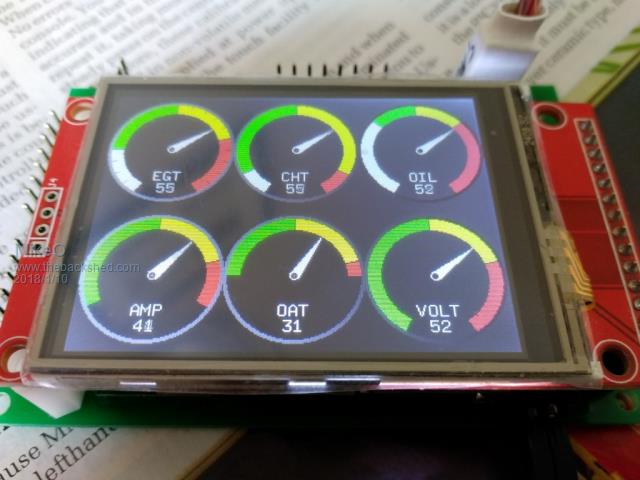

I have also already converted my MX170 weather station data to display to a Android Tablet.
Mike

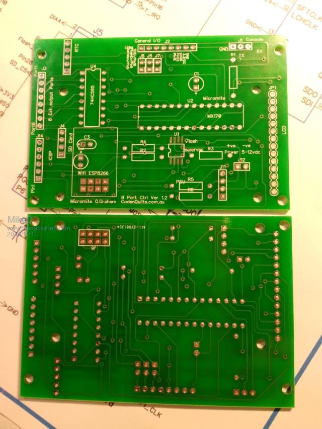

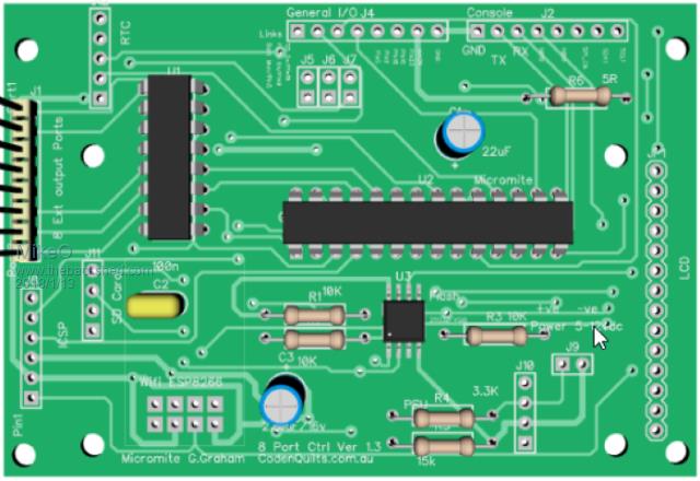

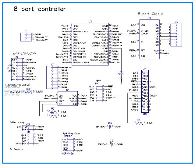

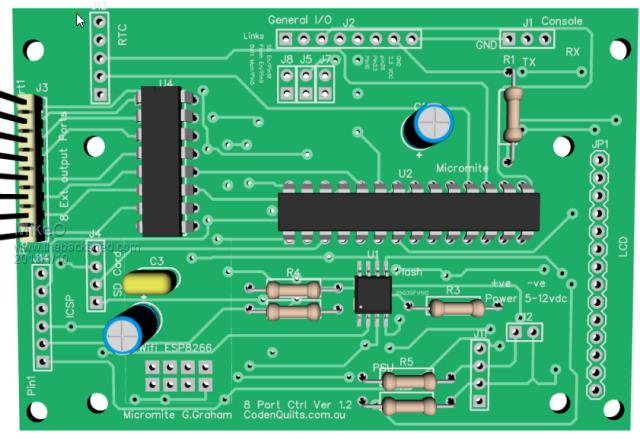

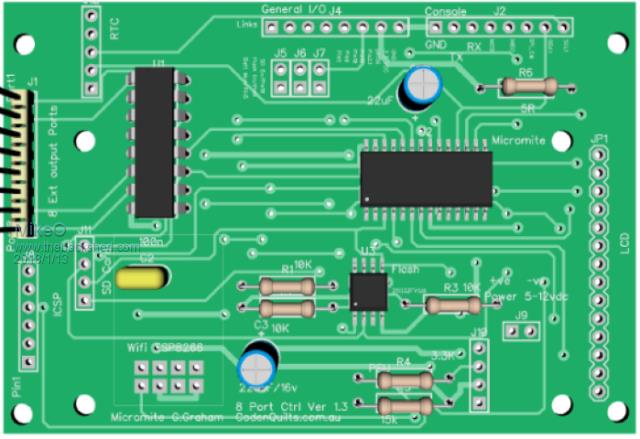

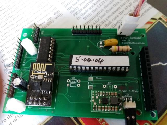

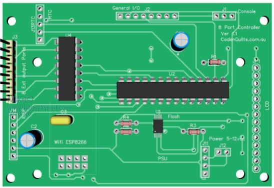

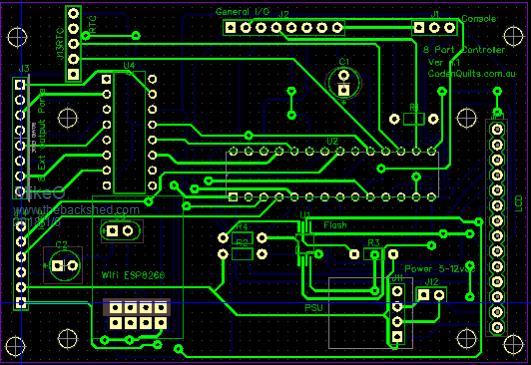

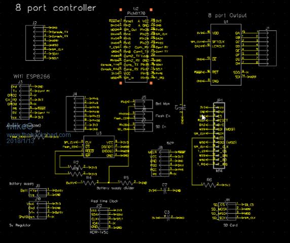

Thanks for the replies, I will get all the various files together over the next week or so. Apart from the Android I have been developing and using the interface components for quite some time so they are reasonably mature and stable. I have used the i/f code for several different projects including weather station and solar/battery monitor. Both of these project have also used an Android device in monitor mode ,ie one way comms only.

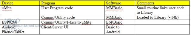

I thought I should outline the concepts. All the MMbasic user programs contain a single small code interface 'hook' plus an optional sub routine for specific interface commands if required.
The code components are as shown in this table.
Communication between the ESP266 (wifi) module and the uMite is via a serial link and the ESP firmware provides UDP ,HTTP messaging and web capabilities, plus built in functions.
I have attached the ESP code to give some idea of the functions available (only a few used are used in the current project) also the Anroid B4A code.
Mike

#Region Project Attributes
#ApplicationLabel: Irrig Client
#VersionCode: 1
#VersionName:
'SupportedOrientations possible values: unspecified, landscape or portrait.
#SupportedOrientations: portrait
#CanInstallToExternalStorage: False
#End Region
#Region Activity Attributes
#FullScreen: False
#IncludeTitle: True
#End Region
Sub Process_Globals
Private usocket As UDPSocket
Dim SendIp As String
Private const devicePort As Int = 5001
End Sub
Sub Globals
Dim sf As StringFunctions
Dim lblReceived As Label
Dim lblF1 As Label
Dim lblLtrs As Label
Dim lblF2 As Label
Dim REC As String
Dim btnSend As Button
Dim tgtspin As Spinner
Dim myarray(8) As String
Dim cfg(10) As String
Dim zn As String
Private txtRepeat As EditText
Private chkWater As CheckBox
Private lblZoneName As Label
Private txtDays As EditText
Private txtOn1 As EditText
Private txtOff1 As EditText
Private txtOn2 As EditText
Private txtOff2 As EditText
Private txtOn3 As EditText
Private txtOff3 As EditText
Private btnStop As Button
Private btnZ1 As ToggleButton
Private btnZ2 As ToggleButton
Private btnZ3 As ToggleButton
Private btnZ4 As ToggleButton
Private btnZ5 As ToggleButton
Private btnZ6 As ToggleButton
Private btnZ7 As ToggleButton
Private btnZ8 As ToggleButton
End Sub
Sub btnSend_Click
SendMessage ("ESP_Irrig:|ESP_Svr:|uMrconfig|1|"&Chr(13) & Chr(10))
End Sub
Sub Activity_Create(FirstTime As Boolean)
If FirstTime Then
usocket.Initialize("usocket", devicePort, 8192)
End If
sf.Initialize
Activity.LoadLayout("irrig")
myarray(0)="Zone Z1"
myarray(1)="Zone Z2"
myarray(2)="Zone Z3"
myarray(3)="Zone Z4"
myarray(4)="Zone Z5"
myarray(5)="Zone Z6"
myarray(6)="Zone Z7"
myarray(7)="Zone Z8"
tgtspin.Initialize("tgtspin")
tgtspin.Prompt="Select Box Number"
tgtspin.AddAll(myarray)
Activity.AddView(tgtspin,0dip,28dip,100dip,33dip)
'tgtspin = "Zone #1"
SendIp="192.168.0.255"
End Sub
Sub SendMessage(sSend As String)
Dim data() As Byte
Dim up As UDPPacket
data=sSend.GetBytes("UTF8")
up.Initialize(data, SendIp, 5001)
usocket.Send(up)
End Sub
Sub tgtspin_ItemClick (Position As Int, Value As Object)
Log(tgtspin.SelectedItem)
zn=sf.Right(tgtspin.SelectedItem,1)
Log(zn)
SendMessage ("ESP_Irrig:|ESP_Svr:|uMrconfig|"& zn &"|"&Chr(13) & Chr(10))
End Sub
Sub usocket_PacketArrived (Packet As UDPPacket)
Log(REC)
REC = BytesToString(Packet.Data, Packet.Offset, Packet.Length, "ASCII")
If sf.instring(REC,"ESP_Irrig|")>0 And sf.instring(REC,"Log|")>0 Then 'Car Timer Result data only
REC=REC.Replace("|ESP_Svr:|ESP_Irrig|Log|6|","")
lblLtrs.text=sf.Splitgetword(REC, ",",2)
lblF1.text=sf.Splitgetword(REC, ",",3)
lblF2.text=sf.Splitgetword(REC, ",",4)
'lblChg.text=sf.Splitgetword(REC, ",",6)
'lblTemp.text=sf.Splitgetword(REC, ",",3)
'lblSOC.text=sf.Splitgetword(REC, ",",8)
'lblhrs.text=sf.Splitgetword(REC, ",",2)
Else If sf.instring(REC,"ESP_Irrig|")>0 And sf.instring(REC,"Config|")>0 Then
REC=REC.Replace("|ESP_Svr:|ESP_Irrig|Config|","")
End If
Log(REC)
lblReceived.Text=REC
End Sub
Sub Activity_Resume
End Sub
Sub Activity_Pause (UserClosed As Boolean)
End Sub
Sub WriteConfig
Dim TextWriter1 As TextWriter
TextWriter1.Initialize(File.OpenOutput(File.DirRootExternal, "Config.txt", False))
For i = 1 To 10
TextWriter1.WriteLine("Line" & i& CRLF)
Next
TextWriter1.Close
End Sub
Sub ReadConfig
Dim TextReader1 As TextReader
TextReader1.Initialize(File.OpenInput(File.DirRootExternal, "Config.txt"))
Dim line As String
line = TextReader1.ReadLine
Do While line <> Null
Log(line) 'write the line to LogCat
Loop
TextReader1.Close
End Sub
Sub txtRepeat_TextChanged (Old As String, New As String)
Log(txtRepeat.Text)
If txtRepeat.Text.Length>1 Then txtRepeat.Text=sf.Left(txtRepeat.Text,1)
If txtRepeat.Text="9" Then txtRepeat.Text=""
If txtRepeat.Text="8" Then txtRepeat.Text=""
If txtRepeat.Text="7" Then txtRepeat.Text=""
If txtRepeat.Text="6" Then txtRepeat.Text=""
If txtRepeat.Text="5" Then txtRepeat.Text=""
If txtRepeat.Text="4" Then txtRepeat.Text=""
If txtRepeat.Text="3" Then txtRepeat.Text=""
End Sub
Sub lblZoneName_Click
If txtDays.Text.Length>10 Then txtDays.Text=sf.Left(txtDays.Text,10)
End Sub
Sub txtDays_TextChanged (Old As String, New As String)
If txtDays.Text.Length>7 Then txtDays.Text=sf.Left(txtDays.Text,7)
End Sub
Sub txtDays_EnterPressed
Log(txtDays.Text)
End Sub
Sub txtOn1_TextChanged (Old As String, New As String)
If txtOn1.Text.Length>4 Then txtOn1.Text=sf.Left(txtOn1.Text,4)
End Sub
Sub txtOff1_TextChanged (Old As String, New As String)
If txtOff1.Text.Length>4 Then txtOff1.Text=sf.Left(txtOff1.Text,4)
End Sub
Sub txtOn2_TextChanged (Old As String, New As String)
If txtOn2.Text.Length>4 Then txtOn2.Text=sf.Left(txtOn2.Text,4)
End Sub
Sub txtOff2_TextChanged (Old As String, New As String)
If txtOff2.Text.Length>4 Then txtOff2.Text=sf.Left(txtOff2.Text,4)
End Sub
Sub txtOn3_TextChanged (Old As String, New As String)
If txtOn3.Text.Length>4 Then txtOn3.Text=sf.Left(txtOn3.Text,4)
End Sub
Sub txtOff3_TextChanged (Old As String, New As String)
If txtOff3.Text.Length>4 Then txtOff3.Text=sf.Left(txtOff3.Text,4)
End Sub
Sub btnStop_Click
btnZ1.Checked=False
btnZ2.Checked=False
btnZ3.Checked=False
btnZ4.Checked=False
btnZ5.Checked=False
btnZ6.Checked=False
btnZ7.Checked=False
btnZ8.Checked=False
SendMessage ("ESP_Irrig:|ESP_Svr:|uMstop|"&Chr(13) & Chr(10))
End Sub
Sub btnZ8_CheckedChange(Checked As Boolean)
If btnZ8.Checked=True Then
SendMessage ("ESP_Irrig:|ESP_Svr:|uMon|8|"&Chr(13) & Chr(10))
Else
SendMessage ("ESP_Irrig:|ESP_Svr:|uMoff|8|"&Chr(13) & Chr(10))
End If
End Sub
Sub btnZ7_CheckedChange(Checked As Boolean)
If btnZ7.Checked=True Then
SendMessage ("ESP_Irrig:|ESP_Svr:|uMon|7|"&Chr(13) & Chr(10))
Else
SendMessage ("ESP_Irrig:|ESP_Svr:|uMoff|7|"&Chr(13) & Chr(10))
End If
End Sub
Sub btnZ6_CheckedChange(Checked As Boolean)
If btnZ6.Checked=True Then
SendMessage ("ESP_Irrig:|ESP_Svr:|uMon|6|"&Chr(13) & Chr(10))
Else
SendMessage ("ESP_Irrig:|ESP_Svr:|uMoff|6|"&Chr(13) & Chr(10))
End If
End Sub
Sub btnZ5_CheckedChange(Checked As Boolean)
If btnZ5.Checked=True Then
SendMessage ("ESP_Irrig:|ESP_Svr:|uMon|5|"&Chr(13) & Chr(10))
Else
SendMessage ("ESP_Irrig:|ESP_Svr:|uMoff|5|"&Chr(13) & Chr(10))
End If
End Sub
Sub btnZ4_CheckedChange(Checked As Boolean)
If btnZ4.Checked=True Then
SendMessage ("ESP_Irrig:|ESP_Svr:|uMon|4|"&Chr(13) & Chr(10))
Else
SendMessage ("ESP_Irrig:|ESP_Svr:|uMoff|4|"&Chr(13) & Chr(10))
End If
End Sub
Sub btnZ3_CheckedChange(Checked As Boolean)
If btnZ3.Checked=True Then
SendMessage ("ESP_Irrig:|ESP_Svr:|uMon|3|"&Chr(13) & Chr(10))
Else
SendMessage ("ESP_Irrig:|ESP_Svr:|uMoff|3|"&Chr(13) & Chr(10))
End If
End Sub
Sub btnZ2_CheckedChange(Checked As Boolean)
If btnZ2.Checked=True Then
SendMessage ("ESP_Irrig:|ESP_Svr:|uMon|2|"&Chr(13) & Chr(10))
Else
SendMessage ("ESP_Irrig:|ESP_Svr:|uMoff|2|"&Chr(13) & Chr(10))
End If
End Sub
Sub btnZ1_CheckedChange(Checked As Boolean)
If btnZ1.Checked=True Then
SendMessage ("ESP_Irrig:|ESP_Svr:|uMon|1|"&Chr(13) & Chr(10))
Else
SendMessage ("ESP_Irrig:|ESP_Svr:|uMoff|1|"&Chr(13) & Chr(10))
End If
End Sub

Update for this project.
I have designed a new board for use as a general control board.
based on MX170 DIP uMite for easy soldering
ILI9341 LCD display support
RTC module
ESP8266 wifi module
4mB of Flash Ram for storage/logging
8 port Ext Output
General 8 Pin connector, 6 general mixed Input/Output/Analog plus 3.3v and Gnd
ICSP connector
Console connector
Pololu PSU module (3.3v), you can choose to use best one for your needs
ie stepup, stepdown, or stepup/stepdown variety. stepdown example
@ Andrew_G you can find most of what you were asking in my post
If anyone wants them all the Gerbers etc are here , I may also have one or two boards available in a few days, $5 plus postage.
Layout 3D Viz and Sch
