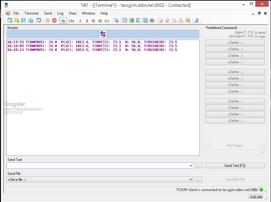

Posts: 10113
Posted: 05:54am 16 Dec 2017
TT flatly refuses to talk to that, but YAT does:
I have yet to work out how to sent CTRL commands(such as CTRL+C etc) via YAT, but it does connect just fine.

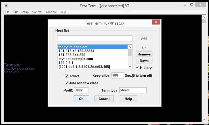

Posts: 10113
Posted: 06:03am 16 Dec 2017
Refuses to connect.....
I have also tried VT100 terminal mode - same result: "Disconnected"
EDIT: 'SETUP' window just on image so you can see my setup. I did try clicking OK....Edited by Grogster 2017-12-17

I will keep experimenting. What version of TT are you using?
I am on 4.91

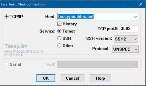

Posted: 06:36am 16 Dec 2017
V4.94 but I have used earlier version without issue.
You were connecting by using "New connection" from the file menu?
Azure
Joined: 09/11/2017
Posts: 446
Posted: 06:44am 16 Dec 2017
I can connect to it in TT.
In the file menu open new connection, select the TCP/IP port you setup in settings and enter port 3002 and telnet as session and it connects.
I am not sure what it is supposed to do, just seems to be send a loopback of what I type when I press enter.
Posts: 10113
Posted: 06:50am 16 Dec 2017
@ Jim - Used 'New connection' put in that information: 'Connection timed out.'
@ Azure - Yep, same process here, but it rejects the connection. Timed out.

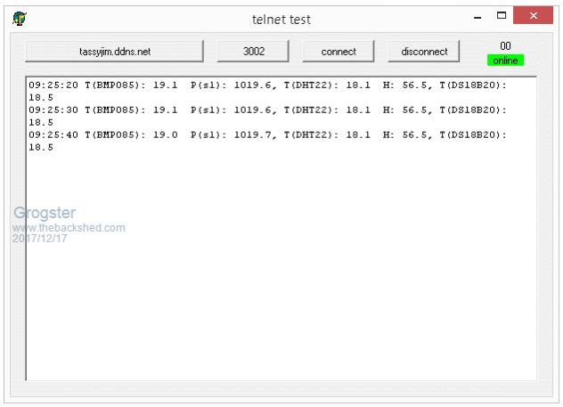

led-bloon
Joined: 21/12/2014
Posts: 210
Posted: 07:51am 16 Dec 2017
Just logged in to tassyjim.ddns.net using Putty .. the micromite is at the command prompt and I can list the program on it!
Will run it now!
MM running now and spitting out data

Posted: 08:18am 16 Dec 2017
@Grogster
I noticed when you select the telnet option it changes the port number you may have already typed in. It will timeout trying to connect to that port.
Sequence is:
Select TCP/IP and tassy...
Select Telnet option
Enter port 3002
Hope that helps.
