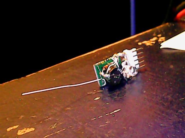

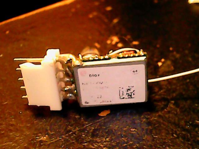

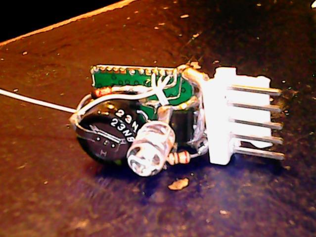

I had thought about sending a sync pulse every second or so to use as a timing tic for the slave microphones. However, this would require a radio receiver, in addition to a radio transmitter in each slave.
1. I don't like having to have have the master transmitter running all the time.
2. There are issues with switching from transmit to receive.
The use of a $5 GPS chip is more cost effective and they all produce a very synchronous 1 Hz time tick accurate to a few uS of each other. I like the ublox NEO-6M. I "Dead Bug" wired directly to the chip and used a short wire antenna. There is a small supercap for backup that lasts for at least a week. I would think it would be hard to beet the GPS solution. Remember, this doesn't move and has plenty of time to get locked to the satellites.
I've made some progress on the microphone sensor.
1. I have a plug-board test circuit working. It is based on an AGC, Automatic Gain Control, amplifier I got off the net. (Roff's circuit, post #10) This works well with a 9mm electrit mike I intend to use.
2. The circuit attempts to keep the output the same amplitude no mater what the sound level comes in from the mick. Of course, the original circuit is modified for my needs. I need to slow down the averaging of the AGC so I can detect a sharp high amplitude shot signal.
