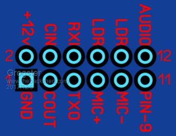

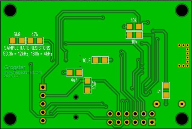

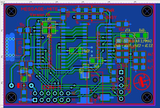

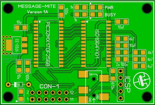

Hi all.
Here is my latest MM board:
This board uses a MM2 as the controller, paired to a ISD1964SYI01 message recorder/playback chip.
This chip costs six bucks and can be configured for 1-8 messages. The more messages, the less the message duration per message. With the 1964 chip, you can get eight messages up to about 8 seconds each at 12kHz sample rate. Sample rate can be changed with simple resistors, with a lower sample-rate resulting in longer messages of lower sound quality. The '01' type chip has line-level output, rather then speaker output.
The idea came from a pal of mine who wanted a bird-scarer with different sounds on it, so this is what I came up with. It also has an LDR connected, so that it will sound during daylight, but automatically be silent when it gets dark. The concept is that it will sound one of the recordings in the chip every five minutes or so, to keep the enthusiastic birds away from his crops. Powered by 1.2Ah Gel-Cell battery and small solar panel.
However, "Bird-scarer-mite" did not sound right, so I thought of what I thought was a better sounding name.
Control of all message playback and recording is done via commands sent to the MM2's COM1 serial port, at any supported baud-rate you prefer. It is done this way to minimize the external connections to the board, but still provide full control over playback and recording. I also wanted to have a waterproof socket on the box as it will live outside, and has to be waterproof, so a waterproof socket with the least number of pins on it is preferred and also is cheaper.
Now, I know what some of you are already thinking having read this far into the thread: "Why didn't he use a $3 MP3 player module, and put the sounds on that?" Good point. However, my pal wanted to be able to easily re-record the messages/sounds, and none of the MP3 player modules can offer recording ability, so that is why I went for the voice recorder chip. Still, the 1964 chip is very affordable at six bucks...
But this board would be useful for anyone wanting voice-prompting or short sound playback for any project at all. Each board would cost about $10 to build, including the MM2 chip, the 1964 chip, the PCB and all the on-board parts.
If this is of interest to anyone, I will build a constructors pack and upload it to my website, and post a link for anyone to download Gerbers, BOM, sample code etc, etc, etc.
