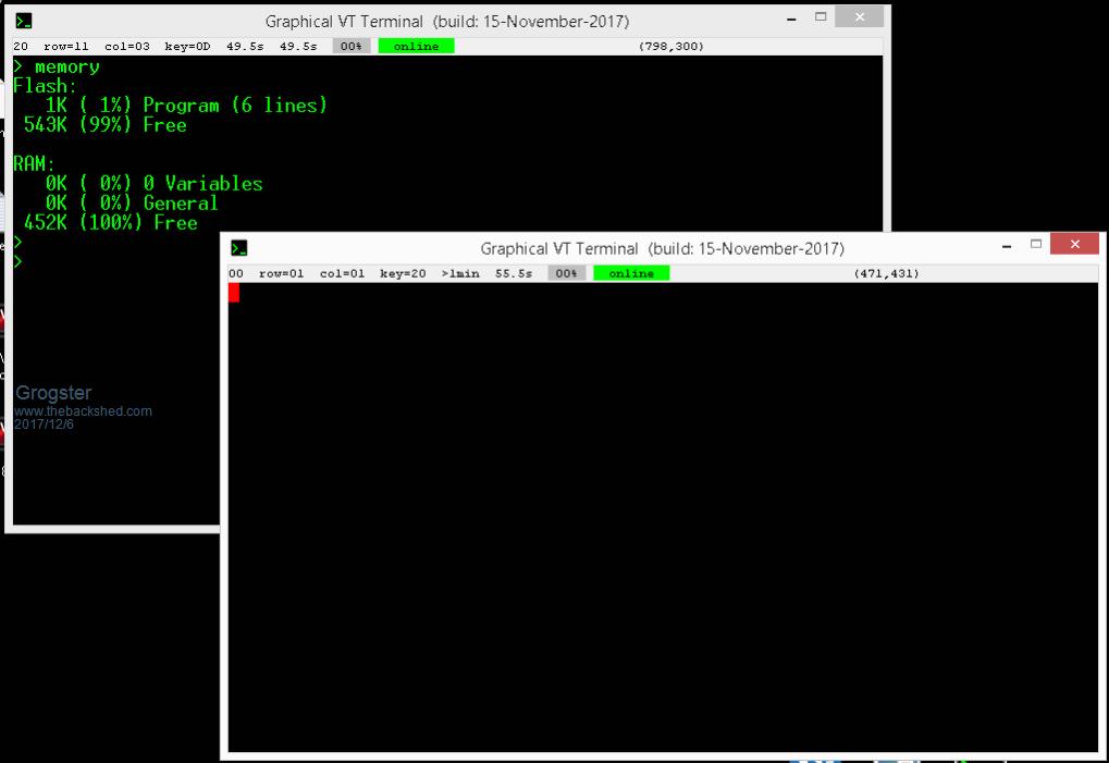

I will plug in several E28's all of which use the 1455 chip, and let you know.
I am still not expecting a problem, but you may in fact be correct so I will post back shortly.
EDIT: Plugged in two E28's and one MMX all with 1455 chips. All running at the same time, all of which were assigned unique COM ports, and I can talk to all of them. Here is a shot of my accessing two different 1455 projects at once:
