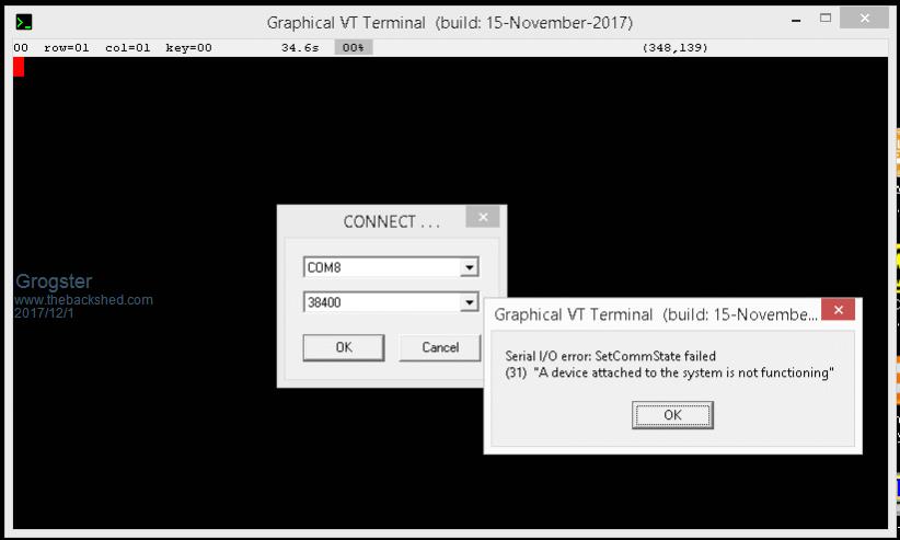

Hi there.
Rob - I get this odd error when I connect a VT100 terminal(Geoff's MX250 one) to GFXterm:
TeraTerm talks just fine to it on COM8, but If I close TT(leaving VT100 connected), and try to connect via GFXterm, I get that error every time. Close GFXterm, reopen TeraTerm, connect to COM8 - away I go no problems.
Any reason why that should be?
I don't care - I was only playing with the VT100 board tonight for something.
Just thought I would report it.
Posted: 06:36am 01 Dec 2017
I don't think that com8 is the problem.
The VT100 code had an issue with it's USB-serial.
MMEdit and a few other programs also have problems talking to them.
It was fixed for some later devices but I don't think the VT100 has been updated.

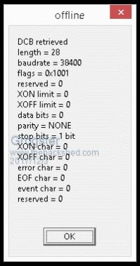

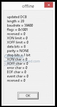

Posted: 11:31am 02 Dec 2017
give this test version a try:
2017-12-02_212819_GFXterm_TEXTD.zip
it should pop up a couple of dialogs, the first showing the DCB retrieved, the second showing the DCB that it is about to try and save. if you can grab an image of each one, it should provide a few clues about what is going on.
rob :-)

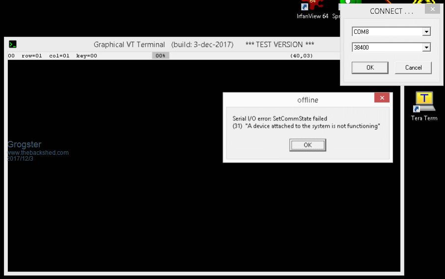

Posted: 11:56pm 03 Dec 2017
right, give this test version a spin:
2017-12-04_095036_GFXterm_TEST_version_E.zip
you'll still see an error, but have the option of ignoring it. tassyjim sent me some info that allowed unravelling the mystery a little more - it looks like there is/was a bug in the microchip USB stack, and that teraterm (rather naughtily) silently ignores the resulting error returned by windows.
rob :-)

Posted: 08:02am 04 Dec 2017
  robert.rozee said   right, give this test version a spin:
rob :-)
THIS ONE WORKS FINE.
I get the error as you said, but I click on IGNORE, and the VT100 terminal is accessible just fine after that. I even connected a MM to it, and can still talk to it fine.
