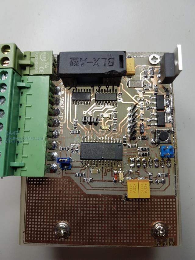

I need some suggestions of what to try next. I have a project PCB (home made single sided) one of the 5 I have made refuses to communicate thru the Console port. I initially went through a fairly thorough check of all of the solder joints and found no issues. I have continuity tested the tracks from the console pins to the chip and tested for shorts from either track. In desperation I have removed the radio unit and replaced the Micromite chip, re-programmed it and can see it boot into the program (Autorun is on). I am using a USB-Serial converter and I can see the LEDs on it flash when I try to communicate with the chip. The PC, USB-Serial and cables work fine on another unit so I am at a loss as to what to try next. Wondering if any shedders have had similar problem that they may have solved? I will post a photo of the unit just in case there is a blindingly obvious error in my construction Please forgive the condion of the PCB/soldering as many components have been removed and replaced

Usually the console 'Just works'.....
I DID run into this kind of issue yesterday with an old project that flatly refused to talk on the console, no matter what.
I fixed that by reflashing the firmware into the chip - then it DID respond.
You say you have reprogrammed the chip. Can you clarify if you just reloaded the BAS file to the MM, or you reflashed the MMBASIC HEX file to the chip.

Gday Grogs, the .hex file I used is a complete copy of data, MMbasic, Libraries, CFunctions, Options and basic program. the only thing that changes between units is an ID number in VAR SAVE.
Out of desperation I just flashed a 28pin DIL chip with the same .hex file and it talks ok

Reflash the standard MMBASIC HEX back into your board - just for the purposes of testing - and see if that gives you the console back.
If it does, then something in the HEX you are programming is causing the issue.
Make sure that when you read the PIC32 with IPE to then export the HEX, that you are reading BOTH the boot memory, and the program memory - you set this in the IPE advanced options.

Grogs, as suggested, I re-flashed the unit with a bare MMBasic 5.04.05.hex file and reset the teraterm back to 38400 baud but still no talkies.

  Quote  Do you have a logic analyser?
Unfortunately I don't have a Logic Analyser in the kit. I am wondering if changing the Vcap may have some effect. I haven't done it as yet as the unit was autorunning and my past experience with bad Vcaps showed that the Micromite wouldn't boot.

OK, no talkies with standard MMBASIC suggests a problem with the connection to the console pins.
I know you have replaced the chip and done some continuity testing. Did that testing involve testing RIGHT FROM THE PIN to the header, and NOT just the solder by the pin?
I am wondering if you need to reflow your solder around the console pins to be totally sure they are actually making contact to the header pins.

Changed the 10UF X5R Vcap with a 47U Tant but no difference. Got out the multimeter again and less than 1 ohm between the gold plated pin and each of the PIC pins. I checked these measurements with another working unit.
Interestingly I get around 19K from pin 11 OR 12 to gnd on a working unit but on the faulty unit I get 19K to gnd on 12 but 10k on pin 11. will investigate further.Edited by OA47 2017-12-01

Thanks again for your help Grogs. There is a track that goes between the GND pin and the Console PIN 11 pin and there was a small solder blob living under the plastic base of the headers removed the plastic base and all is well in the land of the Micromites.
