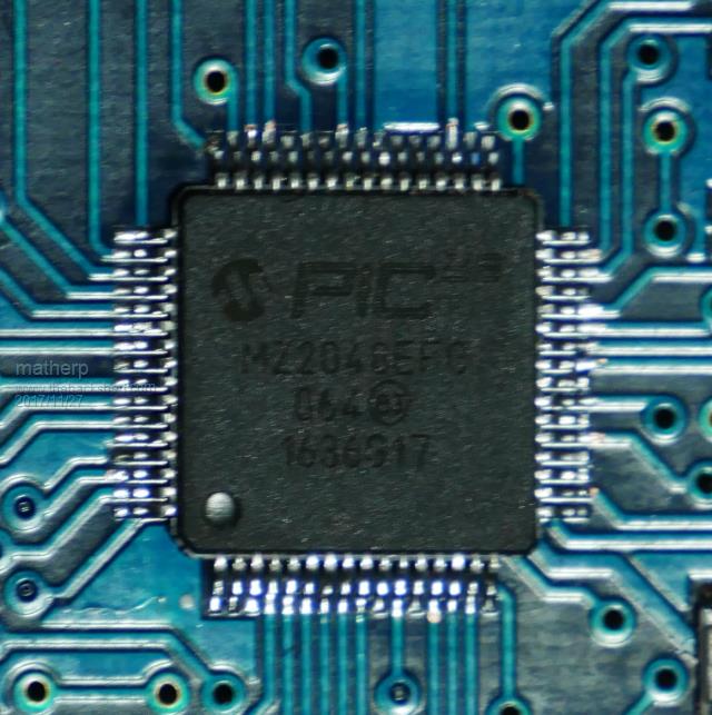

Posted: 10:02pm 27 Nov 2017
I am getting pretty ancient too, and my eyesight is getting steadily worse, I try to avoid the really fine pitch packages and stick with the larger through hole parts and now use sockets for all my ICs.
But there is a bit of a trick to soldering fine pitch packages.
I agree, solder paste is probably not the best technique for do it yourself fine pitch components at home.
Much better is to initially flood all the pins with resin cored solder, and then use solder wick to remove the surplus solder. If you remove too much, its easy enough to put some back.
But with a bit of practice, its possible to very quickly make some pretty lean joints leaving minimum solder remaining. Just enough to see on each pin without any possibility of solder bridges.
If you have fifty pins per side (or whatever) just run down each side with big solder and a big tip.
Its not necessary to solder each pin individually !
Then run down each side with solder wick sucking up the excess.
In just a few seconds its possible to have fifty very neatly soldered pins sitting in a morass of surplus flux. I think that is probably the secret. The solder wick is saturated with flux and leaves a nice shiny solder fillet, as long as you don't remove too much solder.

Solder paste is good if you have a stencil and a reflow oven. I don't like it for manual soldering with an iron. IMHO, you are far better off with fine solder, and some decent flux.
I have had issues in the past with the "Flooding" method, where you just add a whole heap of solder to all the pins and short them all out in a big line of molten solder.
Wicking the excess solder out from between the pins can be a real problem with fine-pin-pitch stuff, as the surface tension can sometimes make tiny little solder hairs stay BEHIND the pins where you can't get at them with the wick. This again, is just MY thoughts on it, and certainly not raining on the parade of those who like that method.

Posted: 10:58pm 28 Nov 2017
Another somewhat controversial trick involves precise positioning of the chip over the pads. Success in soldering requires the pins to be very precisely centered over the pads, and that is not so easy to do.
A very small spot of your favorite glue under the chip will allow you to move the chip around with maybe a pin or a needle under your microscope until its exactly in position.
Then go away for a while and allow the glue to set.
The chip should then not move if a few corner pins are then very delicately soldered first.
Old age brings us patience, as well as sometimes poor vision and/or the shakes!
So its a bit of an old fart's trick that the young guys laugh at.
But it does help a lot.
Its not necessary to bury the chip in high strength epoxy, just a small spot of something less permanent that can easily be prised apart later if necessary.
