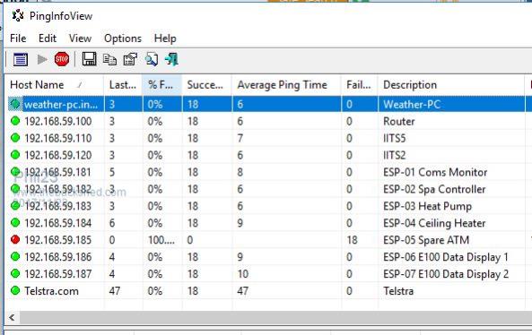

  Grogster said  Do any of the members here have any major problems with that concept?
ESP-8266 users will be compromised.
On mine I use the CP-2102 header for a plug to connect the ESP-01 as I mentioned here....
I could live without that particular connector, but as long as I still had access to Tx & Rx before the 1455, as on Con6.
All my MM's including the E100's are connected by Wifi & I'd be totally lost without that functionality.
Having to take a laptop & USB to all of them for code changes would be a huge PITA.
at should still be available via some means.
Think this applies to all devices using the 1455; Direct Tx & Rx Needs to still be available.
Phil. Edited by Phil23 2017-11-24
Posts: 10111
Posted: 10:32pm 22 Nov 2017
OK folks, thanks.
And Phil - you make a very good point, and hammered home well with the photos.

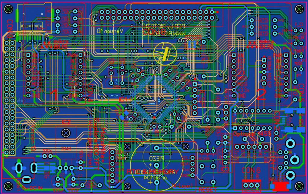

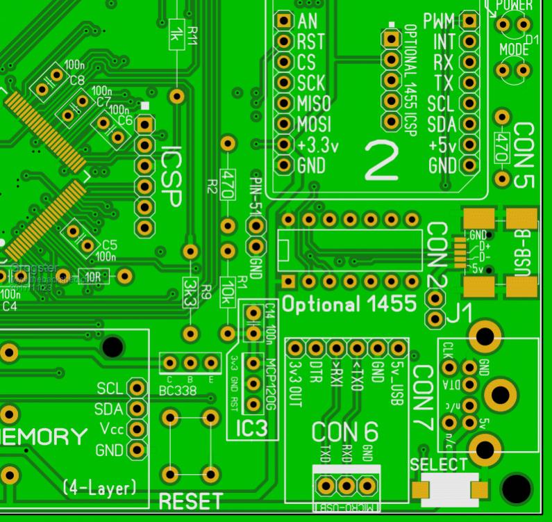

Posted: 01:02am 02 Dec 2017
UPDATE:
OK, here we are with the new design.
- Optional socketed 1455 USB/ICSP interface chip with on-board ICSP for IT
- Silkscreen changes as per WW request(around LED's)
- uSD card socket added(SD #2), upper-left corner.
- CON10 removed.
- PIN_17 added to PIN_51 header as a spare I/O pin.
I will probably tweak a few more things, but this is essentially the new version of the board I plan to get made.
